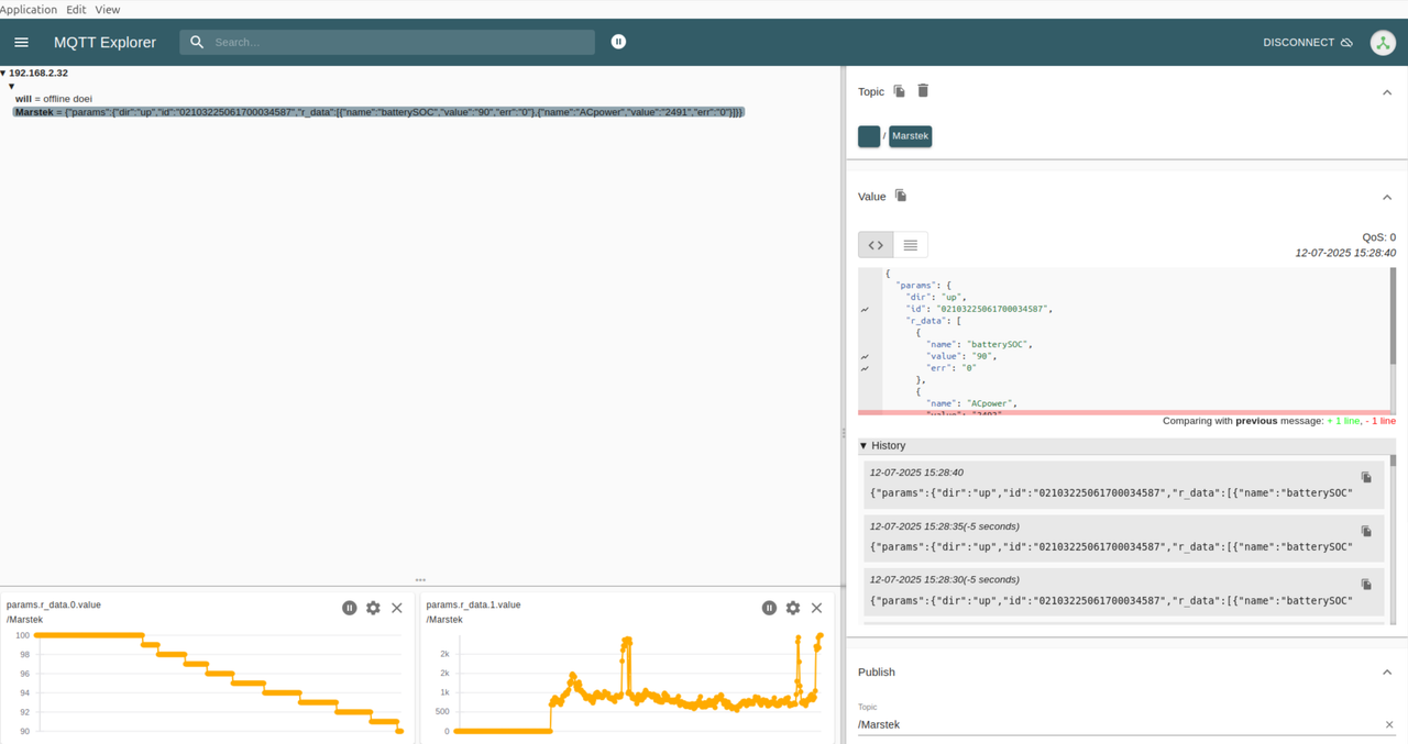

To bad , can't get it running (tried a lot of things):
Message in Mosquito / MQTT Explorer :
Json for MqttMapper :
Device is created in but does not get value's
Logging :
Error : 2025-07-12 12:52:02.077 Error: Invalid Number sValue: '%' for device idx: '%'
When Type /subtype changed the error is gone.
{"params":{"dir":"up","id":"02103225061700034587","r_data":[{"name":"batterySOC","value":"99","err":"0"},{"name":"ACpower","value":"-1153","err":"0"}]}}
"Marstek_SOC": {
"topic": "Marstek",
"type": "243", "subtype": "6", "switchype": "0",
"mapping": {"item": "params/r_data/0/value", "multiplier": 1, "digits": 1}

mosquitto_sub -t /Marstek/# -h 192.168.2.32 -p 1883 -u rene -P rene |jq -r --unbuffered '.[].r_data[1].value'|mosquitto_pub -t ACPower -l -h 192.168.2.32 -p 1883 -u rene -P rene
Domoticz on Docker on Raspberry PI 5 with 500 Gb NvME|Milight|RFXCOM|Goodwe|Smartstuff P1 meter|Buienradar|Afval kalender|Tuya|deCONZ Conbee II| in development Marstek Homebattery 5,12Kwh via Modbus |
- Posts: 26
- Joined: Sunday 05 August 2018 10:13
- Domoticz version: 2025.1
- Location: Eindhoven area
Re: Marstek Battery plugin
I changed the topic to : "topic": "/Marstek/#",
The complete message is returned!

It works for me.
Normal log from Domoticz (no debug or something)
This is the mqttmapper json part:
And when I publish the following payload to Marstek topic with MQTT explorer I get the percentage value updated as seen in the log above.
So perhaps just use the exact payload that is coming out of the ModbustoSerial device without modifying it with JQ

"value": "5120",
"err": "0"
"name": "ACvoltage",
"value": "2341",
"err": "0"
"name": "ACcurrent",
"value": "1045",
"err": "0"
"name": "ACpower",
"value": "-2344",
"err": "0"
"name": "ACfrequency",
"value": "4999",
"err": "0"
"name": "internaltemp",
"value": "417",
"err": "0"
- Posts: 381
- Joined: Saturday 27 February 2016 0:30
- Domoticz version: 2020.2
There probably a configuration error somewhere, as top level topics are not empty (don't start by "/").RNEE wrote: ↑Saturday 12 July 2025 15:48 I changed the topic to : "topic": "/Marstek/#",The complete message is returned!Code: Select all
2025-07-12 15:45:01.525 MQTT Mapper for DR134: 30 a2 01 00 08 2f 4d 61 72 73 74 65 6b 7b 22 70 61 72 61 6d 0®../Marstek{"param 2025-07-12 15:45:01.525 MQTT Mapper for DR134: 73 22 3a 7b 22 64 69 72 22 3a 22 75 70 22 2c 22 69 64 22 3a s":{"dir":"up","id": 2025-07-12 15:45:01.525 MQTT Mapper for DR134: 22 30 32 31 30 33 32 32 35 30 36 31 37 30 30 30 33 34 35 38 "0210322506170003458 2025-07-12 15:45:01.525 MQTT Mapper for DR134: 37 22 2c 22 72 5f 64 61 74 61 22 3a 5b 7b 22 6e 61 6d 65 22 7","r_data":[{"name" 2025-07-12 15:45:01.525 MQTT Mapper for DR134: 3a 22 62 61 74 74 65 72 79 53 4f 43 22 2c 22 76 61 6c 75 65 :"batterySOC","value 2025-07-12 15:45:01.525 MQTT Mapper for DR134: 22 3a 22 38 36 22 2c 22 65 72 72 22 3a 22 30 22 7d 2c 7b 22 ":"86","err":"0"},{" 2025-07-12 15:45:01.525 MQTT Mapper for DR134: 6e 61 6d 65 22 3a 22 41 43 70 6f 77 65 72 22 2c 22 76 61 6c name":"ACpower","val 2025-07-12 15:45:01.526 MQTT Mapper for DR134: 75 65 22 3a 22 2d 31 31 30 33 22 2c 22 65 72 72 22 3a 22 30 ue":"-1103","err":"0 2025-07-12 15:45:01.526 MQTT Mapper for DR134: 22 7d 5d 7d 7d .. .. .. .. .. .. .. .. .. .. .. .. .. .. .. "}]}} 2025-07-12 15:45:04.079 MQTT Mapper for DR134: Sending 2 bytes of data 2025-07-12 15:45:04.079 MQTT Mapper for DR134: c0 00 .. .. .. .. .. .. .. .. .. .. .. .. .. .. .. .. .. .. � 2025-07-12 15:45:04.129 MQTT Mapper for DR134: Received 2 bytes of data 2025-07-12 15:45:04.129 MQTT Mapper for DR134: d0 00 .. .. .. .. .. .. .. .. .. .. .. .. .. .. .. .. .. .. Ю 2025-07-12 15:45:06.532 MQTT Mapper for DR134: Received 165 bytes of data 2025-07-12 15:45:06.532 MQTT Mapper for DR134: 30 a2 01 00 08 2f 4d 61 72 73 74 65 6b 7b 22 70 61 72 61 6d 0®../Marstek{"param 2025-07-12 15:45:06.532 MQTT Mapper for DR134: 73 22 3a 7b 22 64 69 72 22 3a 22 75 70 22 2c 22 69 64 22 3a s":{"dir":"up","id": 2025-07-12 15:45:06.532 MQTT Mapper for DR134: 22 30 32 31 30 33 32 32 35 30 36 31 37 30 30 30 33 34 35 38 "0210322506170003458 2025-07-12 15:45:06.532 MQTT Mapper for DR134: 37 22 2c 22 72 5f 64 61 74 61 22 3a 5b 7b 22 6e 61 6d 65 22 7","r_data":[{"name" 2025-07-12 15:45:06.532 MQTT Mapper for DR134: 3a 22 62 61 74 74 65 72 79 53 4f 43 22 2c 22 76 61 6c 75 65 :"batterySOC","value 2025-07-12 15:45:06.532 MQTT Mapper for DR134: 22 3a 22 38 36 22 2c 22 65 72 72 22 3a 22 30 22 7d 2c 7b 22 ":"86","err":"0"},{" 2025-07-12 15:45:06.532 MQTT Mapper for DR134: 6e 61 6d 65 22 3a 22 41 43 70 6f 77 65 72 22 2c 22 76 61 6c name":"ACpower","val 2025-07-12 15:45:06.532 MQTT Mapper for DR134: 75 65 22 3a 22 2d 31 31 33 39 22 2c 22 65 72 72 22 3a 22 30 ue":"-1139","err":"0 2025-07-12 15:45:06.532 MQTT Mapper for DR134: 22 7d 5d 7d 7d .. .. .. .. .. .. .. .. .. .. .. .. .. .. .. "}]}} 2025-07-12 15:45:07.026 deCONZ: Pushing 'onHeartbeatCallback' on to queue 2025-07-12 15:45:07.049 Tuya: Pushing 'onHeartbeatCallback' on to queue 2025-07-12 15:45:07.077 deCONZ: Processing 'onHeartbeatCallback' message 2025-07-12 15:45:07.077 deCONZ: Acquiring GIL for 'onHeartbeatCallback'
However, this seems to work, so don't try to fix something working
