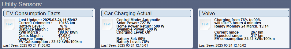

With the ideas and setup of myself and the help of Claude I present you my EV Consumption script.
What is needed
- a text sensor named EV Consumption Facts (Facts added to avoid naming problems within Domoticz)
- a switch sensor type doorbell with the name Reset EV Data
- you will have to create a file EV_Consumption.csv to start with in your /home/pi directory
- the contens of the file are these
timeStamp;odometer;batteryLevel;deltaDistance;kWhTotal;deltakWh;kWh100km;euro;a>
01-01-2025 01:00;15513;;;2562.958;;;;
and the script

-- Main script
        devices = {'Charging Level', 'Reset EV Data'},
        timer = {'at 23:56'}
    logging = {
        level = domoticz.LOG_DEBUG,
        marker = "----- EV Consumption -----"
    data = {
        previousSelectorLevel = { initial = 0 }
        -- Load data from CSV
        local csvData = loadDataFromCSV()
        if not csvData then
            domoticz.log('Failed to load data from CSV', domoticz.LOG_ERROR)
            return
        -- Read current sensor values
        local sensorData = {
            selectorLevel = domoticz.devices('Charging Level').levelVal,
            batteryLevel = domoticz.devices('XC40-ChargeLevel').nValue,
            currentOdometer = domoticz.devices('Volvo-Odometer').nValue,
            currentkWhTotal = domoticz.devices('Laadpaal').WhTotal / 1000,
            temperature = tonumber(domoticz.devices('Buitentemperatuur').sValue)
        -- Check if Charging Level changed from > 0 to 0
        if sensorData.selectorLevel == 0 and domoticz.data.previousSelectorLevel > 0 then
            -- Process data and update display
            processEVData(domoticz, sensorData, csvData)
        -- Update previousSelectorLevel
        domoticz.data.previousSelectorLevel = sensorData.selectorLevel
        -- Save data to CSV only on the last day of the month at 23:56
        if isLastDayOfMonth() and device.isTimer then
            local displayData = {
                currentOdometer = sensorData.currentOdometer,
                batteryLevel = sensorData.batteryLevel,
                distance = sensorData.currentOdometer - csvData.beginningOfTheMonthOdometer,
                kWhPartial = sensorData.currentkWhTotal - csvData.beginningOfTheMonthkWhTotal,
                kWhTotal = sensorData.currentkWhTotal,
                euro = (sensorData.currentkWhTotal - csvData.beginningOfTheMonthkWhTotal) * CONSTANTS.PRICE_PER_KWH,
                avgTemp = sensorData.temperature,
                evConsumption = (sensorData.currentOdometer - csvData.beginningOfTheMonthOdometer > 0) and (((sensorData.currentkWhTotal - csvData.beginningOfTheMonthkWhTotal) / (sensorData.currentOdometer - csvData.beginningOfTheMonthOdometer)) * 100) or 0,
                normalizedKWh = normalizeToTargetLevel(domoticz, sensorData.batteryLevel, sensorData.currentkWhTotal - csvData.beginningOfTheMonthkWhTotal),
                lastUpdate = os.date('%Y-%m-%d %H:%M:%S')

Here are the data that are displayed:
Current Odometer: 17349 km
Battery Level: 56 %
Distance February: 99 km
kWh February: 5.85 kWh
Costs February: 1.46 €
Average Temp: 2.8°C
EV Consumption: 26.66 kWh/100km
Battery level normalized to 82%
Original kWh loaded: 5.85 kWh
Normalized kWh: 26.39 kWh
