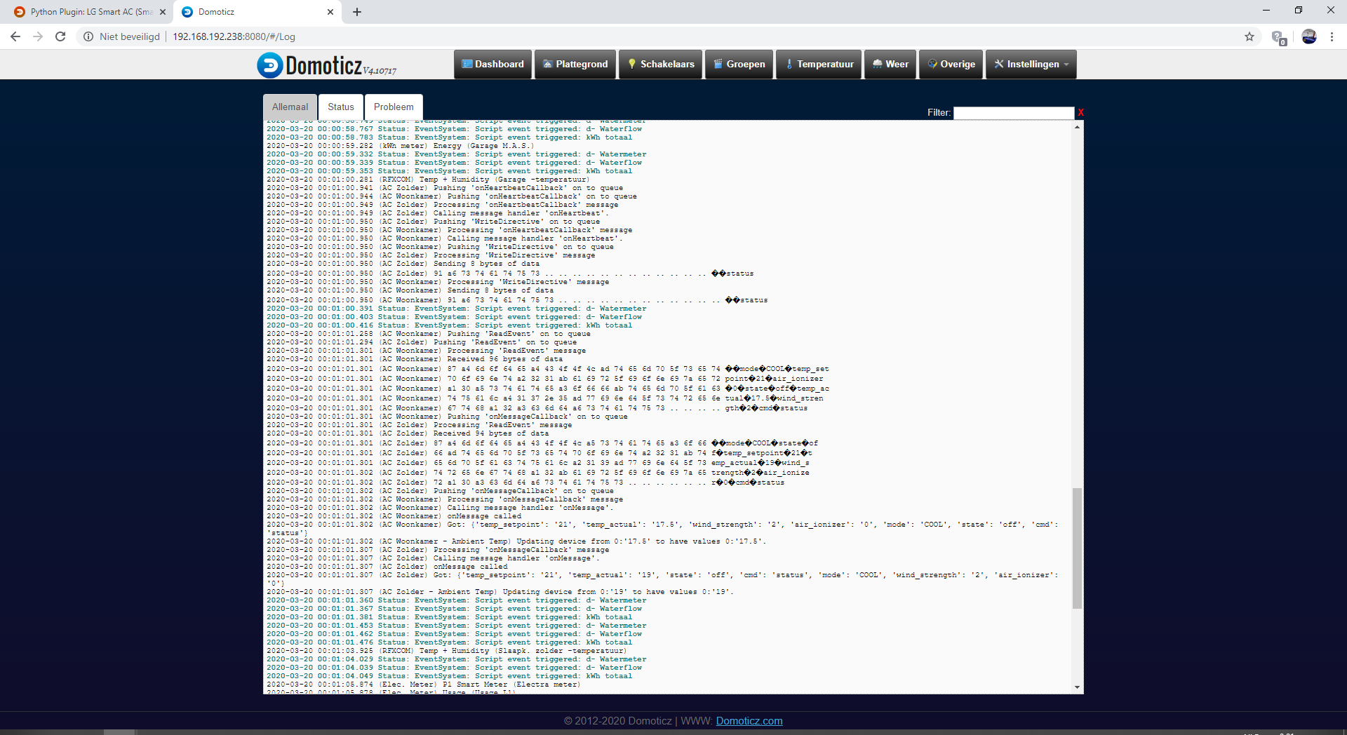

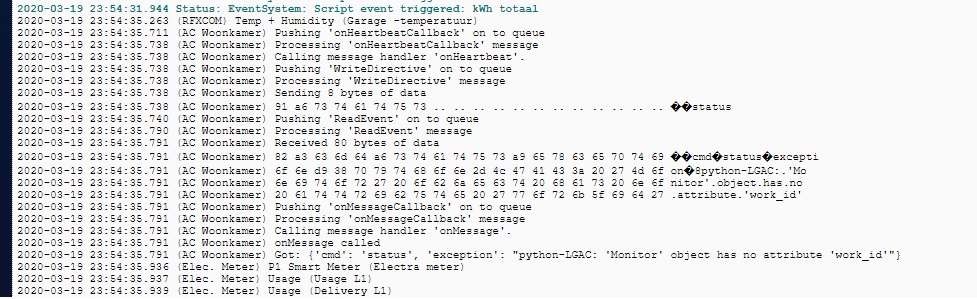

When I start (or restart) Domoticz:
After a while:
After a while:

When you receive {'cmd': 'status', 'exception': "python-LGAC: 'Monitor' object has no attribute 'work_id'"} seems you loose connection with the server but don´t know why.
I would try to get a new "refresh_token".
