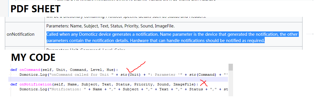

i do not know how to use (or how to active) "onNotification" callbacks function, who can tell me ? i find in Developing_a_Python_plugin.pdf .but is too simple
I Created a virtual hardware which download from "https://github.com/domoticz/domoticz/bl ... emplate.py"
this is my code :

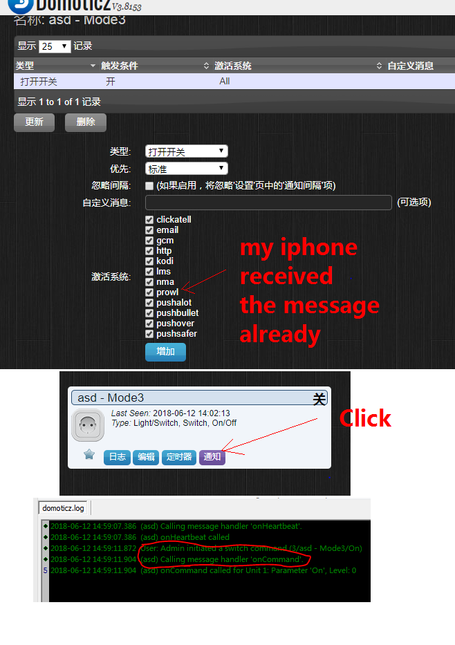

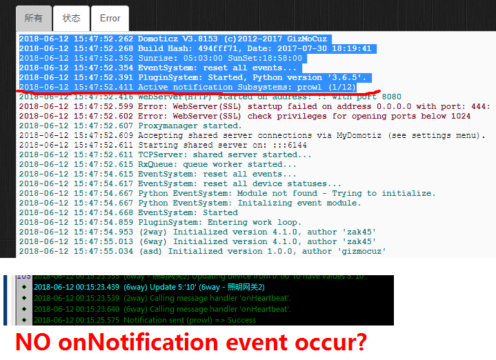

and i've active all Notification system , as matter of fact,my phone is aleady receiving Notification(prowl)
and this is runing debug logs
I mean when i press "switch" button . the onCommand function executioned and loged at history file but。。。 the onNotification no run yet

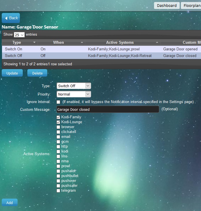

  • Line 122: Domoticz.Notifier(Parameters["Mode4"]), this registers the plugin as being able to recieve notifications. Mode4 is a parameter to the plugin that holds the name such as "Kodi-Lounge" or "Kodi-Family" in my case
  • Line 488: def onNotification(self, Name, Subject, Text, Status, Priority, Sound, ImageFile): Called when notifications are sent
Once the plugin is enabled and running you should be able to send notifications to it by selecting it under Notifications for devices:
