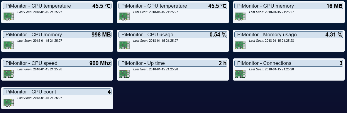

A small plugin available for the Raspberry Pi:
https://github.com/Xorfor/Domoticz-PiMonitor-Plugin
To monitor CPU speed, usage, temperature, etc.
Xorfor
Re: Python Plugin: PiMonitor
Added extra devices, like memory, up time, number of network connections, etc.
