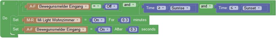

daconas
- Posts: 17
- Joined: Wednesday 22 March 2017 9:31
Re: Python and Blockly Problems
the Problem is the Motion sensor always give a off state when is triggered
when i use it without time it works perfect but i need it by night ( sunrise or bei time ) but when i set it between a time it turns on every minute but not without time.
what is wrong or what can i do ?

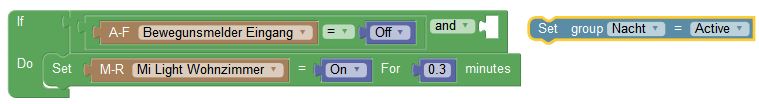

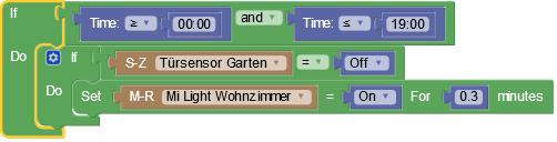

daconas
- Posts: 17
Hello, thank you
looks komplex, i check this
but when i test it with a lamp i turns not on automatic
so i want it with motion sensor
and second pic
i try one with schwitch not motion but nothing happens.
can you explain why pic 3 works but when i use the same with sunset it turn on again and again
when the problem the off state why works without time ?
and second pic

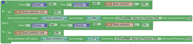

freijn
- Posts: 536
- Joined: Friday 23 December 2016 16:40
- Domoticz version: Stable
- Location: Netherlands Purmerend
This is how I managed to get it to work :
I think it has to do with 2 times AND where you need an OR

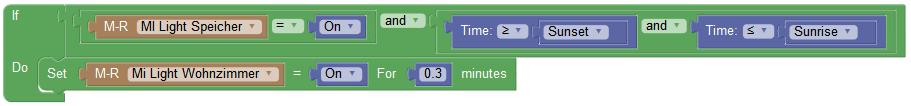

daconas
- Posts: 17
ok, but think "or" means either sunriser or sunset ?
i found some exaples but it works not by me
https://gathering.tweakers.net/forum/li ... 1530723/25
ok i try it but it is the same light goes on and off
the problem is when i use time the light goes automatic on without a Trigger.
- and.png (49.15 KiB) Viewed 4272 times
freijn
- Posts: 536
Now I see your "problem"
Please put the "Spots achtertuin" in a groep.
then in the Groep item hit Timers.
In timers you can configure them to go on and off with sunset and sundown.
Forget the Blocky !!!

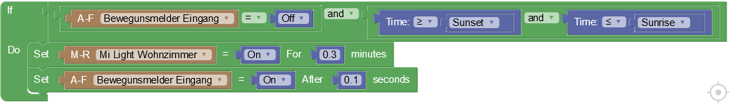

daconas
- Posts: 17
@ freijn
you have a Link or pic or you mean the group setting ?
@StanHD
i think about this problem but i try alredy this and the loop starts every new minute but i try this one at Night
Thank you
@StanHD
Thank you
- state on.png (19.17 KiB) Viewed 4234 times
- StanHD
- Posts: 347
- Joined: Friday 12 July 2013 16:09
- Target OS: Windows
- Location: East Sussex, UK
So, after 0.3 minutes what happens to the "Bewegunsmelder Eingang"? .... nothing? .... So it is still off?
But the Mi-Light has now turned off, so a change has been made and thus the conditions are again met such that the "Do" event will be triggered again ..... and again until you are outside the time limits, or the "Bewegunsmelder Eingang" is on where the conditions are not met and the "Do" condition is therefore not carried out.

First of all i try this an i try the motionsensor i put in on the frontdoor and its working without loop or somthing.
Then i want try to turn on only by night but the loop comes i think about a error in the time in the moment of 00:00 and i try time
sunset to 11:00 pm an 07:00 pm to 11:00 pm but nothing works
i lookt many example but nothing.
now is the lampe quiet i think it is the or between the sunset and sunrise i hope the light goes on when sun goes down and no loop comes.

Hello, now its working with last konfiguration " Sunset or Sunrise"
Thank you to freijn the " or " was right .
