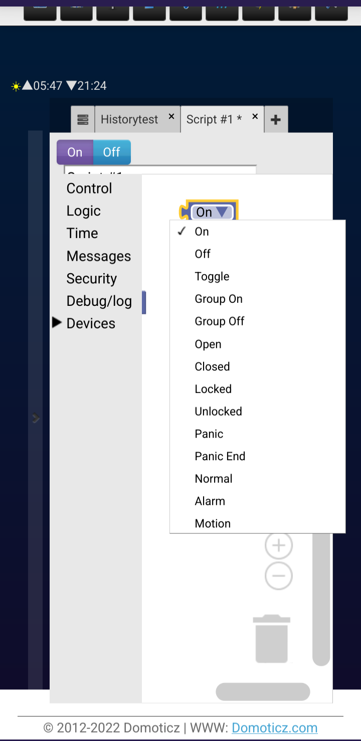

In logic, switch you can select the toggle

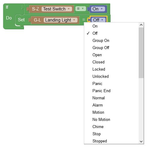

This is exactly what i thought, so i'm not going mad after all, definitely on beta 14318 but this is what I see.

No amount of browser cache refresh made any difference however open the same page in Chrome and guess what !!!
Very odd

Then it is definitely browser cache. Delete all as described in the wiki and restart browser.
