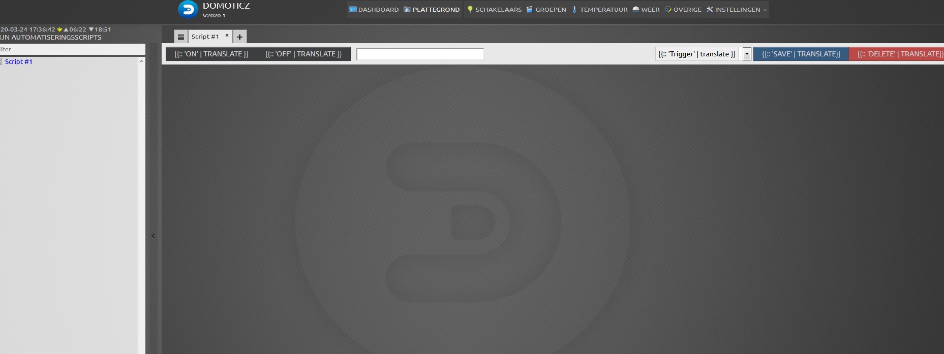

Hello peeps, I have had a crash of my SD-card but luckily i save the database. So, format a new card, put buster on it, then domoticz, placed the database back. So far, so good, all fine. However, opening my events tab shows no normal screen. Script I had running under blockly works, however I have no interface left. That is, cannot switch the script on or off, not even delete it or make a new one. Last state was off and it still is.
I suspect having a problem with my factories.js in the /events folder.
Anybody has a solution to this? It is pretty annoying ;)

I did. Afterwards, I rebooted the pi with event option off. Then put it back on and booted the pi again. WORKED! That is, everything is fine now but I am not sure why :)) Still, thx a million even for giving my post some time. :D

I am facing the same issue on my PI after the upgrade to 2020.1.
Tried clearing every cache, rebooted several times, no luck at all. The problem persists on different devices (Laptop / Phone).
Only the edge browser shows at least the headers in the right pane at the top, but the blockly section is empty in any case.
