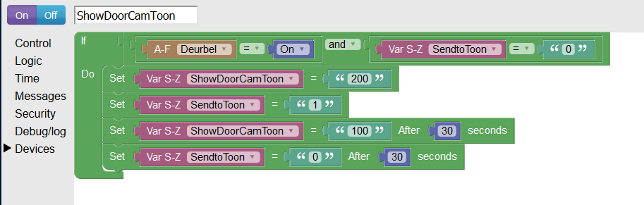

This is the Lua I got so far but I'm not a programmer:
So below the Blocky which I would like to have in lua.
I appriciate any help
if (deviceName=='Deurbel') then
if deviceValue == "On" and (uservariables["SendtoToon"] == "0") then
set uservariables["ShowDoorCamToon"] == "200" ) then
set uservariables["SendtoToon"] == "1" then
set uservariables["ShowDoorCamToon"] == "100" "AFTER 30"
set uservariables["SendtoToon"] == "0" "AFTER 30"
return commandArray

See below for the dzVents equivalentXavier82 wrote: Sunday 15 December 2019 13:22 So below the Blockly which I would like to have in Lua. I appreciate any help![]()
return
on =
devices =
'Deurbel',
logging =
level = domoticz.LOG_DEBUG,
marker = 'Deurbel',
execute = function(dz, item)
if item.active then
dz.log('Device ' .. item.name .. ' was pushed', dz.LOG_DEBUG)
local sendToToon = dz.variables('SendtoToon')
local showDoorCamToon = dz.variables('ShowDoorCamToon')
if sendToToon.value == '0' then
showDoorCamToon.set('200')
showDoorCamToon.set('100').afterSec(30)
sendToToon.set('1')
sendToToon.set('0').afterSec(30)
}Debian buster, bullseye on RPI-4, Intel NUC.
