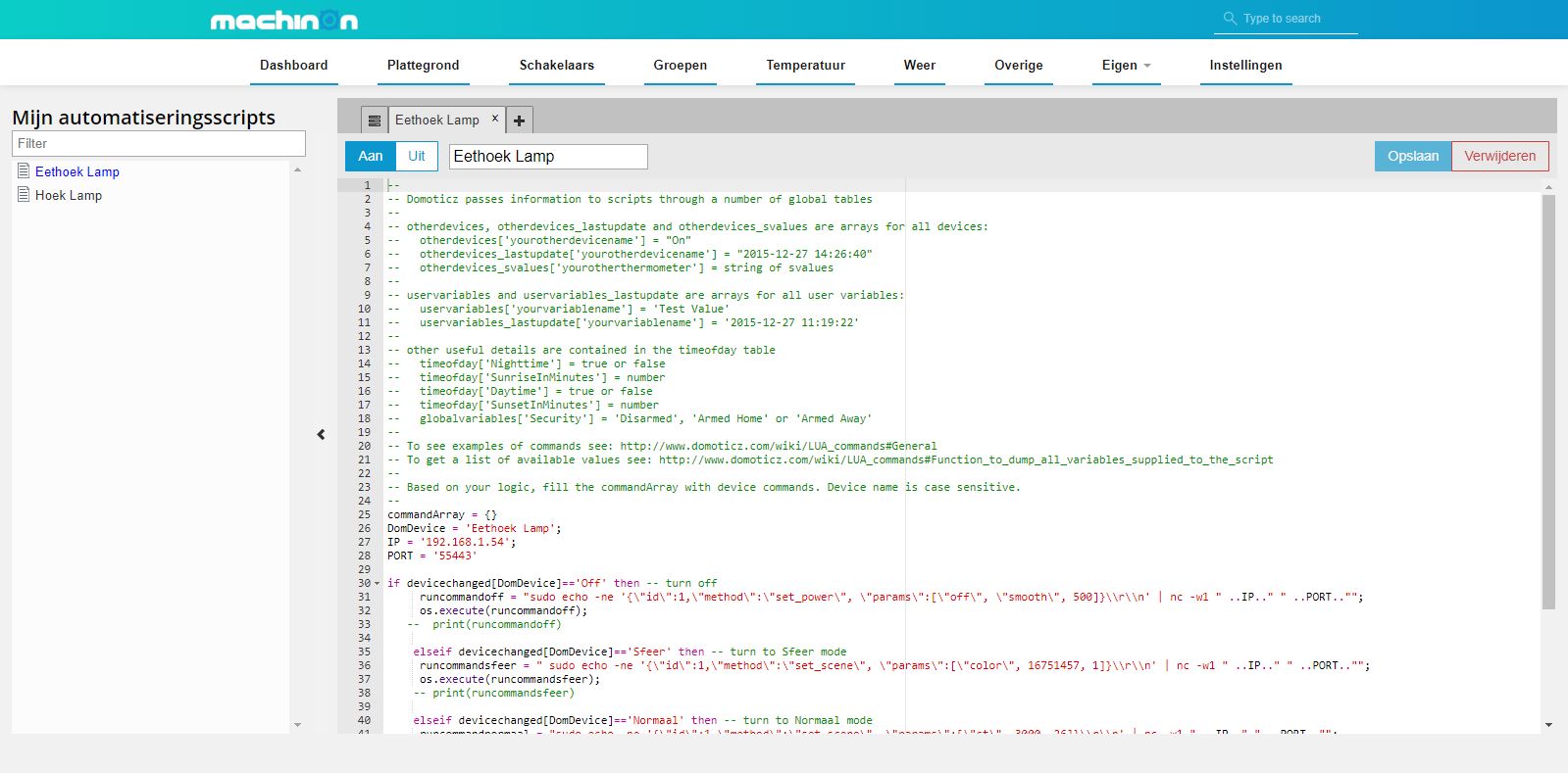

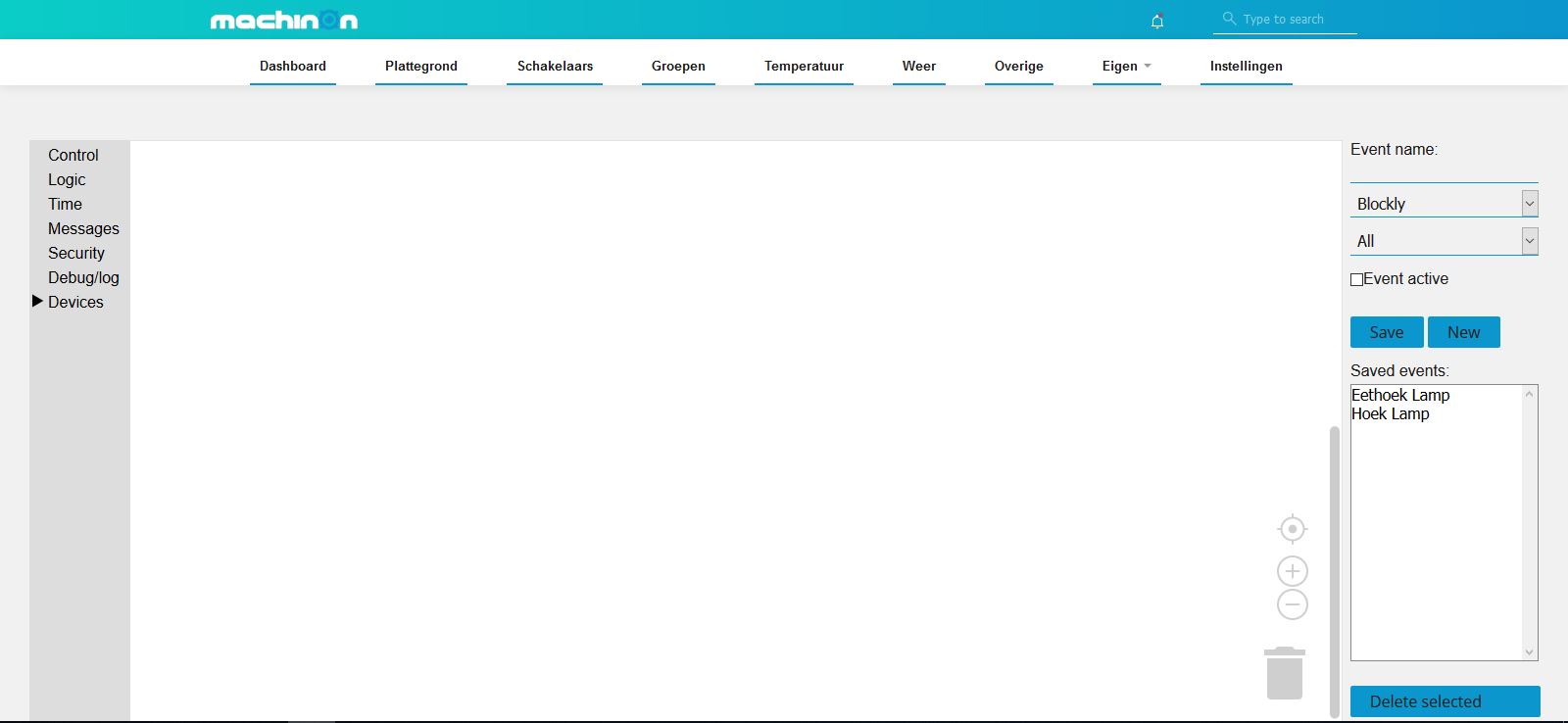

When I looked at your screen shot I thought...hey that is not what my UI is showing....???
I tried the machinon and default theme in a firefox browser, but both UI's are not showing the correct menu in the "Events" page so I was missing some menu items. When I installed Google Chrome it showed the same UI as your screenshot.
It seems to be difficult in domoticz to get a good working UI theme tested on all browsers and devices (phones, tables, PC, etc.) is it?
Anyway thanx for your help!
Re: attempt to index global 'devicechanged' (a nil value)
gschmidt wrote: Friday 28 December 2018 9:32 When I looked at your screen shot I thought...hey that is not what my UI is showing....???
Your welcome. Can you please show the difference between the browsers ? And after taking the screenshots, please try again after deleting the browser- and appcaches.
gschmidt
Posts: 200
Joined: Thursday 20 December 2018 11:03
Post by gschmidt »
Here you go! The Machinon Theme
2 screenshots of what happens when I select the "Events" Page in "Settings" in Domoticz on a Raspberry Pi
Quite different if you ask me ;-)
gschmidt wrote: Friday 28 December 2018 10:54 Here you go! The Machinon Theme
Yes they are different but if I look at this page with firefox I see something more like the chrome one. I guess this is because of some cache left behind.
Have a look at https://support.mozilla.org/en-US/kb/storage and delete cache before trying again.

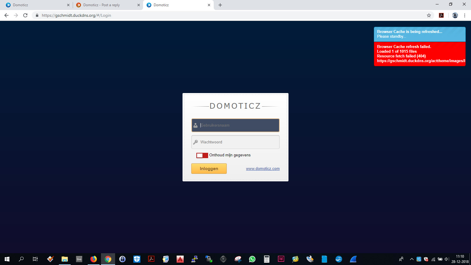

When I connect to my duckdns site (either Android Phone or Laptop Chrome) I get an error that my browser cache refresh failed
I swithed a few hours ago from theme back to default because not all menu items were shown in the machinon theme, when I tried to follow the instructions from Jos
But in the local HTTP site I have no problems in Chrome.
Strange
gschmidt wrote: Friday 28 December 2018 11:23 It gets more strange though:
Strange
Indeed not what I expected but I don't know anything about duckdns. Maybe better to open a new topic for this in "other questions..." or a better suited one ?
gschmidt
Posts: 200
Post by gschmidt »
I switched theme back to default and back to machinon and now everything seems to be normal again in Android and Chrome...looks like it was a hickup

gschmidt
Posts: 200
Post by gschmidt »
And also firefox showing the correct page after deleting cookies and data in firefox options
So this topic is solved!
