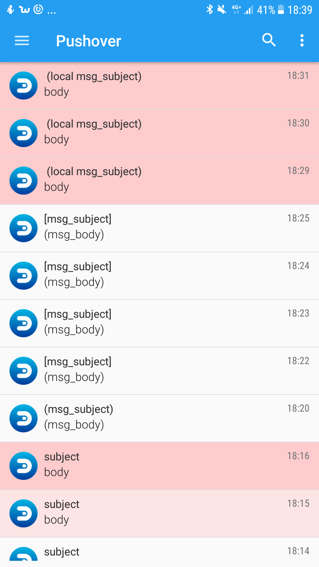

okey, so I got this to work:
if ("1" == "1") then
    print("testing")
    commandArray['SendNotification']='subject#body#2'
return commandArray
but I want to add subject, body and priority as variables
like:
local msg_subject = "Kjøleskap"
local msg_body = "Det er for varmt"
local msg_pri = "1"
But when I paste the variable it just writes out the text, can't find a way to include the variables
Any ide?

extracted from :
http://www.domoticz.com/wiki/Events
commandArray['SendNotification']='subject#body#0'
so the word body is a string, you var needs to be a string, you need to concatuate it in the command ..
bodytext="something nice"
commandArray['SendNotification']='subject#'..bodytext..'#0'
Hope this puts you in the right direction

works ;)
