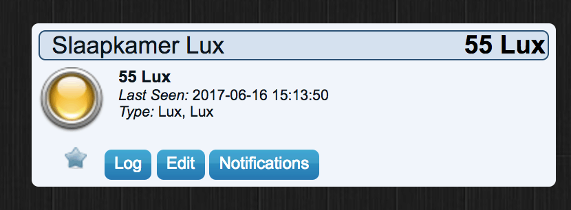

I have a nice Lux sensor in my Domoticz :
I made a Lua script to get that Lux value and do things with it, i made a debug script to check why it's not working that contains :
print('LUA Custom : Device changed, not triggered the donker scene')
print(' ####lux debug: ')
print(tonumber(otherdevices_svalues['Slaapkamer Lux_Utility']))
print(otherdevices_lastupdate['Slaapkamer Lux'])
But for whatever reason it's not printing the Lux value of the sensor... console output says :
2017-06-16 15:18:19.291 LUA: LUA Custom : Device changed, not triggered the donker scene
2017-06-16 15:18:19.291 LUA: ####lux debug:
Any idea on what i'm doing wrong?

You're checking the values of sensor ['Slaapkamer Lux_Utility'], but the name of the sensor is ['Slaapkamer Lux'] ?
