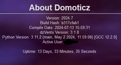

Re: 2024.7 stops working every few days
Post by Dave21w »
No issues here, what platform o/s etc
2024-08-02 15_02_46-Window.jpg (27.66 KiB) Viewed 3717 times
