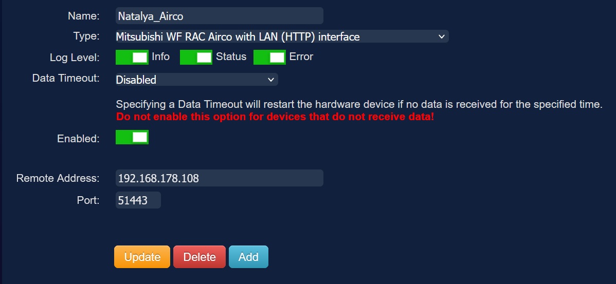

Since owning them i enabled the hardware pluging Mitsubishi WF RAC Airco with LAN (HTTP) interface for each airco, so three in total.
Schermafbeelding 2025-09-09 123038.jpg (91.25 KiB) Viewed 69 times
