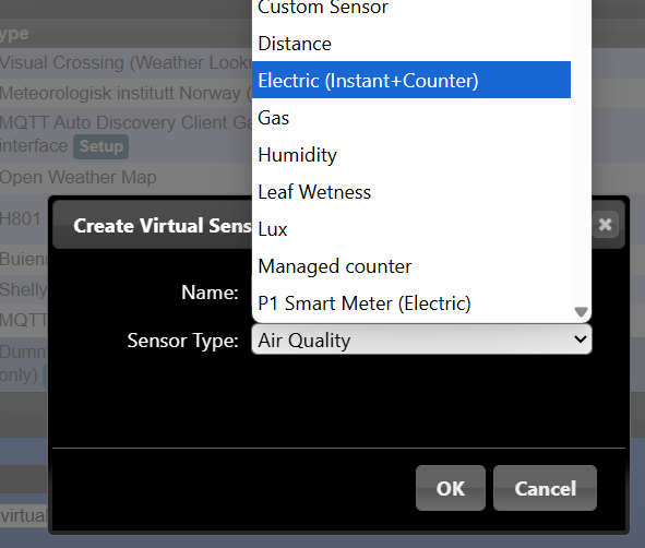

Sub type it not "instant + counter"
I create a Dummy device Type "Electric (instant + counter). But in the device list, the subtype is not "instant + counter". It reads "kWh". See screenshots. Do I make something wrong?

Re: Sub type it not "instant + counter"
Unfortunately the device type names were not always implemented all the way through.
You did it correct. It is also listed as type General, kWh on the Wiki: https://wiki.domoticz.com/Dummy_for_vir ... d_counter)
You get a device that displays the instant usage and a kWh counter
