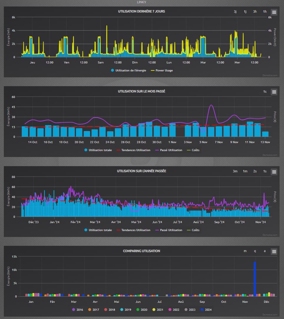

I'm experiencing an issue with my electric counter graph.
I have a module getting live electricity usage from my counter and I retrieve these values in domoticz
Time to time it gets wrong values (ie really high ones) that I correct in the database.
Meanwhile even after corrections I still see a huge value in November (see my graph below in blue)
As I don't know the way it is computed could someone help me finding a way to correct this one in november?

How have you done the correction, as that could be the result of duplicated records in the Multimeter_Calendar table for this device?
Just open a copy of the current domoticz.db and open that with "SQLite Expert Personal" so you can check the table for this device.

there was no duplicate
after a deep dive I found that there are 2 columns in the METER_CALENDAR table named VALUE and COUNTER
VALUE is the total consumption per day
COUNTER is the sum of the previous total + the current day
so I correctly modified the values but not the total counter hence the residual million watts computed
to correct it properly the last correct sum value must be taken and then I did a proper sum after each day on excel
saved the DB and reinjected it into domoticz
it works well !
solved now
