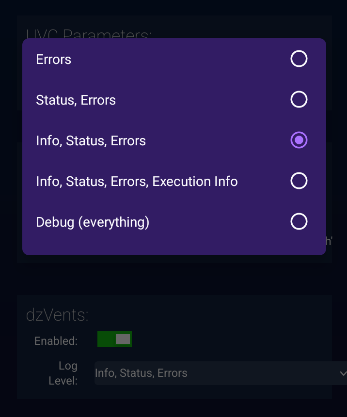

And set in menu setup - settings, tab other, the dzVents logging to including execution info.

You can set the basic dzvents logging level in menu setup - settings, tab other.
If you want to deviate from that default logging level add the log level setting in the script. If no log level setting in the script it will take the default log level.

Check your dzvents global logging settings at menu Setup -Settings, tab Other. But for me it all works as expected.

I and Walter asked several times now to select a specific log level in the application settings and no one mentioned if they specified this level.
Without this it is hard to debug the issue.
There is also another setting 'Log event script triggers', is that enabled or disabled?

I did use several times different settings in Setup -> Settings -> Other
My favorite setting is the setting: Info, Status, Errors, Execution Info as a default.

The effect of all my existing log settings now seems to be reduced to:
2024-07-07 21:30:04.473 Status: EventSystem: Script event triggered: /path-to/domoticz/dzVents/runtime/dzVents.lua
I think I am going crazy. What goes wrong here?

Posts: 5844
Domoticz version: 2024.7
Re: dzVents: Logfile has less info
With default log level in settings
info,status,error,execution info
and no log level defined I get below with the test script.
When I set LOG_INFO in the script I get no execution lines (as expected)
 2024-07-08 08:10:55.976 Status: User: admin (IP: 192.168.1.58) initiated a switch command (107/Test/On)
2024-07-08 08:10:55.979 Dummy: Light/Switch (Test)
2024-07-08 08:10:56.007 dzVents: Handling events for: "Test", value: "On"
2024-07-08 08:10:56.007 dzVents: log_script: ------ Start internal script: logging_test: Device: "Test (Dummy)", Index: 107
2024-07-08 08:10:56.007 dzVents: log_script: INFO log line!
2024-07-08 08:10:56.007 Status: dzVents: log_script: STATUS log line!
2024-07-08 08:10:56.007 Error: dzVents: log_script: ERROR log line!
2024-07-08 08:10:56.007 dzVents: log_script: ------ Finished logging_test
