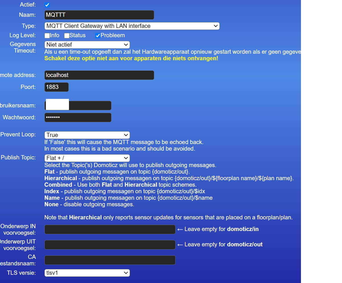

Hi Waaren
I wanna use your mqtt script to pass data to mqtt (nodered) when a uservar changes. (for the volume script you just got working :-)
So i changed the variables section with the right uservar.
Questions
1. Does this script uses the mqtt hardware plugin with the mqtt username and password ?
2. Which value do i use for MQTTTopic = "sometopic/somesubtopic"
see my mqtt attachment, do i have to fill this with "domoticz/out" ?
-- mqqt
-- gebruikt deze domoticz mqtt username en pwd ?
-- welke waarde moet ik intikken bij MQTTTopic? domoticz/in domoticz/out

Got in working in domoticz, but Node-red does likt the message it gets...not proper json....
My changes
payload = '{"device":' .. '"NRvolume",' .. '"value":' .. item.value .. "}"
local mqttCommand = "sudo mosquitto_pub -u xxx -P xxx -t domoticz/out -m " .. payload
Jablotron connection, Ikea

That jason forming line doesn't look right....maybe:
payload = '{"device":"'..NRvolume..'","value":' .. item.value .. '}'
and think you need "" around the message payload in the os.execute:
local mqttCommand = 'sudo mosquitto_pub -u xxx -P xxx -t domoticz/out -m "' .. payload..'"'
