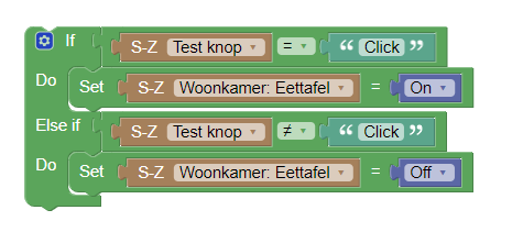

I did some more tests and found out that it works fine in Blockly, so it seems to be related to dzVents.
This works:
This does not work:
