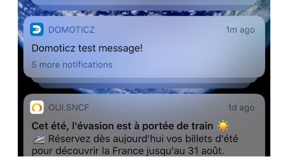

I decided to investigate and I saw the JSON command used by the TEST button. I then integrated this command in my dzVent script as follows:
domoticz.openURL('http://192.168.1.30:8080/json.htm?type=command&param=testnotification&subsystem=fcm&extradata=midx_1')
The testnotification command works and a notification is sent to a specific device.

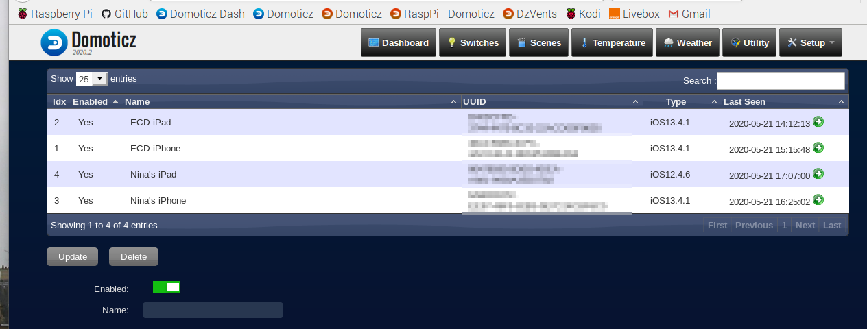

As to midx_1, this is the mobile id given in the mobile device page. Please see attached image of web page. TEST buttons on the same web page will send the JSON command which uses midx_1 as the extradata. Testnotification command uses a different midx_? for each registered mobile device.
The following JSON command will send a Test notification to the first register device mobile device.
Thus, my interest to send a message to when Alarm is Set; when Alarm is On, etc.

Hello again,
I tried the latest version of the script and there is still neither e-mail nor notification.
One of the stanzas from a Police songs says:
Too much information is going through my head.
Too much information is driving me insane
Overkill ...
As I said previous, It would be cool to have DOMOTICZ issue notification alerts on a smartphone to filter out the "junk" messages be they from professional or personal sources. Getting to the essentials.
Should I try PROWL or Telegram apps to receive notifications?
Please see the screen shot of the test notification which I received from the JSON testnotification command.

Hello Waaren,
Your last post made me think that there must have been something obvious which I missed.
If it worked for you, my issue was elsewhere.
Sorry for my clumsiness but the Google Cloud Messaging parameter was not enabled.
Because the test button worked in both the Mobile Devices and on Notification Setting pages, I assumed that this parameter should left disabled as per default setting.
I would recommend a cosmetic change to the GUI. Please add FCM Messaging along side the Google Cloud Messaging Title. It would help newbies like me to leave you in peace.
Now that the Notifications page is set. I am getting a James Bond message on the phone and a Zorro message on the Pad.
Thanks a lot for your patience and sorry for the blooper. :D :D :D
