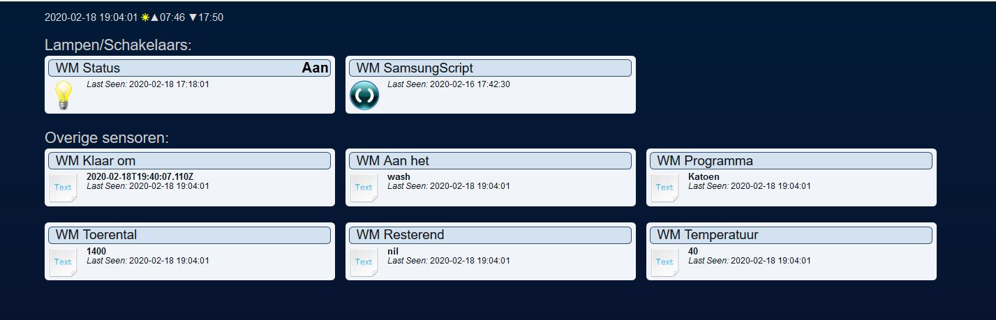

This is my first dzVents script to get the status from the samsung wasmachine (https://developer.samsung.com/smartthings) . I get most of the Json data in to virtual switches. But there are some tings i cant find out.
For the wm_status i use .checkFirst() so the log of the divices show only state changes. How can i use that for the text switches so only the message is updated when there is an change. i got now a lot of log pages with the same state.
for the WM Klaar om i get "completionTime": {"value": "2020-02-18T19:40:06.568Z"} how can i translate that to 20:40 (1 hour offset and date is not relevant)?
From the json "data" i get
"data": {
            "value": "{\"payload\":{\"x.com.samsung.da.state\":\"Run\",\"x.com.samsung.da.delayEndTime\":\"00:00:00\",\"x.com.samsung.da.remainingTime\":\"01:35:00\",\"if\":[\"oic.if.baseline\",\"oic.if.a\"],\"x.com.samsung.da.progressPercentage\":\"53\",\"x.com.samsung.da.supportedProgress\":[\"None\",\"Weightsensing\",\"Wash\",\"Rinse\",\"Spin\",\"Finish\"],\"x.com.samsung.da.progress\":\"Wash\",\"rt\":[\"x.com.samsung.da.operation\"]}}"
for as example the washerSpinlevel i get
"washerSpinLevel": {
            "value": "1400"
The waserSpinLevel i read with local washerSpinLevel = item.json.main.washerSpinLevel.value
how can i get from data. The progressPerecentage and the remainingTime ?
Are there more sugestions to improve this script?

Re: Samsung Washmachine read status from json "NOOB Quistion"
Tjeerd13 wrote: Tuesday 18 February 2020 19:37 For the wm_status i use .checkFirst() so the log of the divices show only state changes. How can i use that for the text switches so only the message is updated when there is an change. i got now a lot of log pages with the same state.
Too many questions to answer in one pass :D So lets start with the first two..
About checkFirst() for text sensors. There is no native dzVents method for that but you can use this function
local function updateTextOnlyWhenChanged( textSensorName, newText)
    local textDevice = domoticz.devices(textSensorName)
    if textDevice.text == newText then
        return
        textDevice.updateText(newText)
The time conversion is a bit more complicated when you are not exposed to Lua patterns yet. First the dateTimeString is split into date time components and after that these components are used to build the timestamp. Then the offset is added to the timestamp and finally the calculated timestamp is converted into a time string.
local function convertTime(dateString, offset )
    local function makeTimeStamp(dateString)
        local pattern = '(%d+)%-(%d+)%-(%d+)%T(%d+):(%d+):(%d+)(%.*)' -- %d+ = 1 or more digits , %.* = 0 or more any character
        local xyear, xmonth, xday, xhour, xminute, xseconds = dateString:match(pattern) -- split the string using the pattern
        local convertedTimestamp = os.time({year = xyear, month = xmonth, day = xday, hour = xhour, min = xminute, sec = xseconds})
        return convertedTimestamp
    return os.date('%H:%M:%S', makeTimeStamp(dateString) + offset )
domoticz.log('Converted time is ' .. convertTime("2020-02-18T19:40:06.568Z", 3600), domoticz.LOG_FORCE)
As requested; some suggestions in the code below.
Obviously not tested as I do not own such a fancy machine.
Any questions please feel free to ask.

After some modification of the code from Waaren its working:

The "If switch on" and "if switch off" was not working i used; "if switch on..... else .. end.
Adding extra space in headers = { ['Authorization'] = 'Bearer '.. API },
I can't figure out how to get info fram the .data string.

Tjeerd13
Posts: 34
Joined: Thursday 07 May 2015 16:57
Location: Assen
Re: Samsung Washmachine read status from json "Working so far" trouble getting json data query
Post by Tjeerd13 »
Thanks so far,
I can't find out how to get the remainingTime:
Tjeerd13 wrote: Tuesday 25 February 2020 17:57 Most of the time i get: attempt to index a nil value (field 'something')
I't driving me crazy ;-)
It looks like the machine is not consistent in its returns. It returns the remaining time intermittent in two different keys.
The script below looks at both keys

With a lot of help from Waaren (THANKS FOR THAT ! !) below is the working script.
With a litle ToDo list.
Dashboar OK.JPG (87.35 KiB) Viewed 10916 times

 	WHen activated you should find your  	'deviceTypeName' and	'deviceTypeId'  in the Domoticz log.
 	I have only one samsung smart device. I expect that if you have more Samsung devices they al appear with diverent descriptions
local API = 'Your API KEY'
local scriptVar = 'Samsung_ID_JSON'
local LOGGING = true
return
    on =
        timer =
            'every minute', -- just an example to trigger the request
        devices =
            50,              -- Just on Switch to activated the script manualy for testing.
        httpResponses =
            scriptVar, -- must match with the callback passed to the openURL command
    logging =
        level = domoticz.LOG_DEBUG,
        marker = scriptVar,
    execute = function(dz, item)
    	local wm_status = dz.devices(WM_STATUS)
    	local wm_percent = dz.devices(WM_PERCENT)
        if item.isTimer or item.isDevice then
            dz.openURL({
                url = 'https://api.smartthings.com/v1/devices/',
                method = 'GET',
                callback = scriptVar, -- httpResponses above.
            return
        elseif item.ok then
            if (item.isJSON) then -- when recognized as json then dzVents will convert it to a table for you
                rt = item.json.items
                    -- dump the string represenation of the complete table to log
                     dz.log('\n-\nAnd now The Device INFO of your API \n-\n ', dz.LOG_DEBUG)
                    dz.utils.dumpTable(item.json)
            return
                dz.log('result was not recognized as a JSON', dz.LOG_ERROR)
            dz.log('result was not OK', dz.LOG_ERROR)
        dz.log(item,dz.LOG_ERROR) -- dump all to log as one long string
Pi3, Pi4, Pi4 for Testing, Dashticz, RFXtrx433, Nest: "Thermostat V2, V3, Hello". Honywell Lyric T6R, RFXCom, KaKu, HUE, P1, Open Zwave USB,
Podarcis
Joined: Sunday 26 April 2015 18:05
Re: Samsung Washmachine read status from json "SOLVED"
Post by Podarcis »
That curl-command helped! Thanks. Working now like a breeze!
