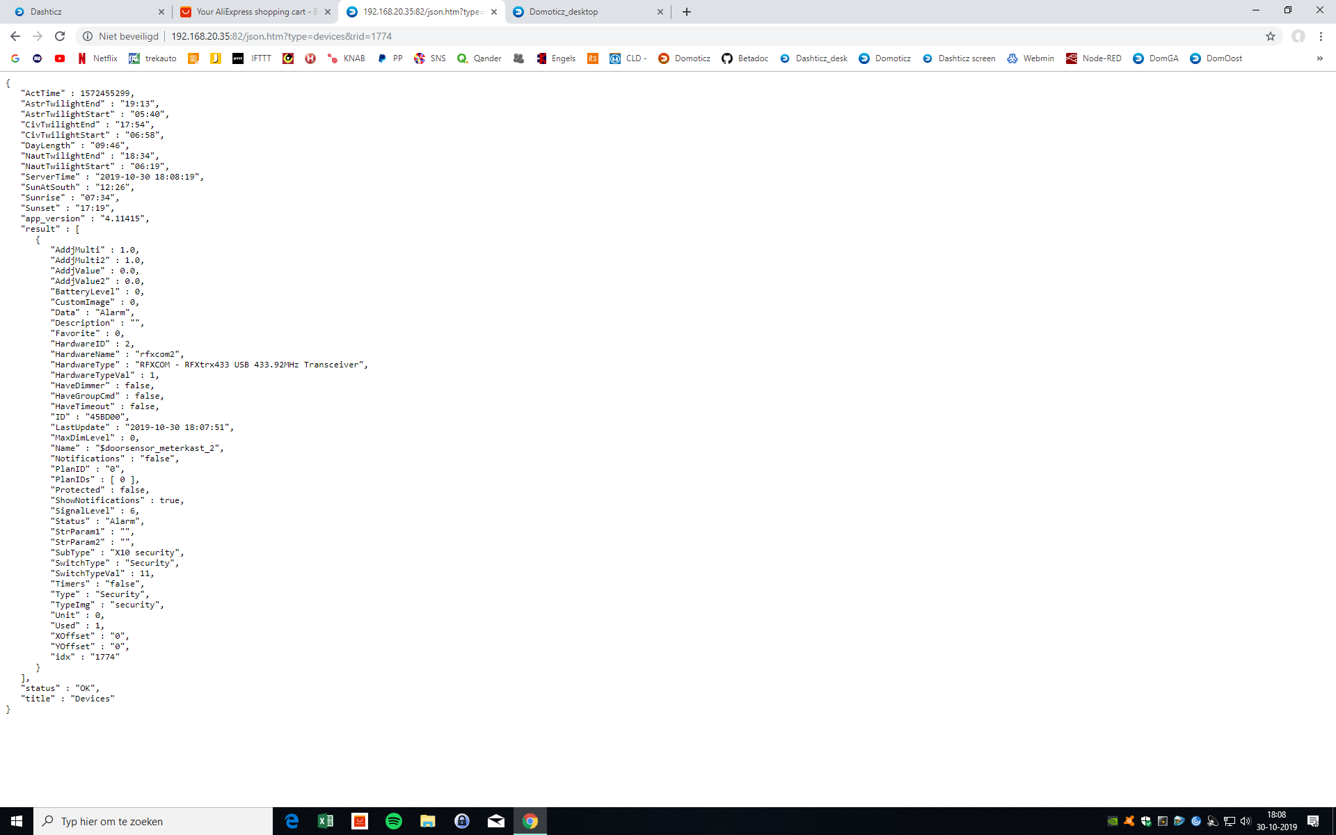

3. The cheaper sensor '$doorsensor_meterkast_2 sends only an on message i think, i attached a dump with:
http://192.168.20.35:82/json.htm?type=d ... ayhidden=1
when i open/close the sensors i see data and status change from Action, to ALarm etc. but when i use these values as item.state it does not work
Can you look at my datadump for an explanation
PM: i use 2 extra sensors that are copies off my real sensors because dashticz interpretates these sensors wrong and diferently...
--http://192.168.20.35:82/json.htm?type=devices&rid=1774&displayhidden=1
--kijk naar status en data

open state is _State: Open, nvalue=2, Svalue = Open
close state of this device is .... nothing
and when i do this a couple of times i also get _State: Open when closing it...
so not relyable, look likes a cheap device with no on/off or open/close
Think i use this as a toggle... and buy kerui ones, those gives open and close for $7

Re: wait for x seconds  [Solved]
pvklink wrote: Thursday 31 October 2019 21:38 I included the logfile.
OK. What I see in the dumps is that the state can be 'Normal' or 'Open' (I guess 'Open' is "Alarm')
So if you change the
if item.state == 'Alarm'
to
if item.state == 'Open'
and
if item.state == 'Motion'
to
if item.state == 'Normal'
this part should work

open, close, motion and alarm did not work, lots of times is sends open instead of close.. this var is not stable
i tried another var, nvalue (with your dump-advise), that did the trick!
if item.name == 'doorsensor_meterkast_2x' then
if dz.devices('doorsensor_meterkast_2x').nValue == 2 then
dz.devices('doorsensor_meterkast_2').open().checkFirst()
dz.helpers.globalMessage2(dz,item,info,messageTable,'add', ' SENSOREN: Beweging gedetecteerd op device: ' .. item.name .. ' om:' .. dz.time.rawTime .. ' status: deur is open...')
elseif dz.devices('doorsensor_meterkast_2x').nValue == 4 then
dz.devices('doorsensor_meterkast_2').close().checkFirst()
dz.helpers.globalMessage2(dz,item,info,messageTable,'add', ' SENSOREN: Beweging gedetecteerd op device: ' .. item.name .. ' om:' .. dz.time.rawTime .. ' status: deur is dicht...')
