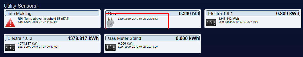

Ragelink
Joined: Saturday 29 June 2019 10:06
Domoticz version: 4.10717
Re: Script to parse Electricity form P1 Smart Meter reading
Post by Ragelink »
2019-07-26 12:56:00.496 Status: EventSystem: Script event triggered: /home/pi/domoticz/dzVents/runtime/dzVents.lua
2019-07-26 12:56:07.169 Status: EventSystem: reset all events...
2019-07-26 12:56:07.170 Status: dzVents: Write file: /home/pi/domoticz/scripts/dzVents/generated_scripts/Volvo Lader.lua
2019-07-26 12:56:07.171 Status: dzVents: Write file: /home/pi/domoticz/scripts/dzVents/generated_scripts/P1 meter script.lua
2019-07-26 12:57:00.485 Status: dzVents: Info: SME 0.1.7: ------ Start internal script: P1 meter script:, trigger: every 1 minutes
2019-07-26 12:57:00.505 Status: dzVents: Debug: SME 0.1.7: Processing device-adapter for Stroom huis: P1 smart meter energy device adapter
2019-07-26 12:57:00.507 Status: dzVents: Debug: SME 0.1.7: Processing device-adapter for Verbruik Laag: Counter device adapter
2019-07-26 12:57:00.508 Status: dzVents: Debug: SME 0.1.7: Set Verbruik Laag to: 461852
2019-07-26 12:57:00.511 Status: dzVents: Debug: SME 0.1.7: Processing device-adapter for Verbruik Hoog: Counter device adapter
2019-07-26 12:57:00.512 Status: dzVents: Debug: SME 0.1.7: Set Verbruik Hoog to: 0
2019-07-26 12:57:00.514 Status: dzVents: Debug: SME 0.1.7: Processing device-adapter for Levering Laag: Counter device adapter
2019-07-26 12:57:00.516 Status: dzVents: Debug: SME 0.1.7: Set Levering Laag to: 0
2019-07-26 12:57:00.518 Status: dzVents: Debug: SME 0.1.7: Processing device-adapter for Levering Hoog: Counter device adapter
2019-07-26 12:57:00.519 Status: dzVents: Debug: SME 0.1.7: Set Levering Hoog to: 0
2019-07-26 12:57:00.521 Status: dzVents: Error (2.4.19): SME 0.1.7: Wrong device (sub)type ==>> Failed to set nil (-,) to: 1291
2019-07-26 12:57:00.522 Status: dzVents: Error (2.4.19): SME 0.1.7: Wrong device (sub)type ==>> Failed to set nil (-,) to: 0
2019-07-26 12:57:00.523 Status: dzVents: Info: SME 0.1.7: ------ Finished P1 meter script
The " verbruik Laag" value is equal to the Total KWH showed on the meter and 1291 value is the current usage

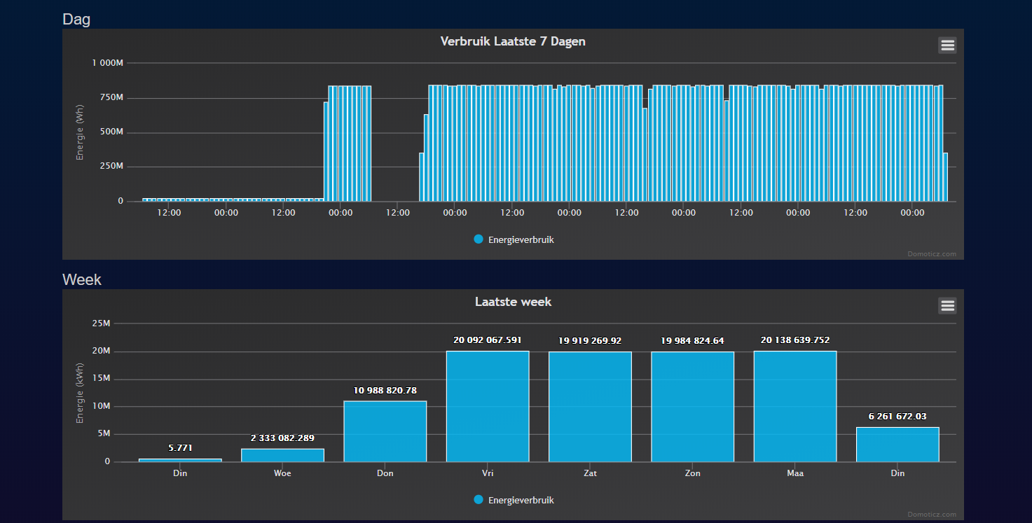

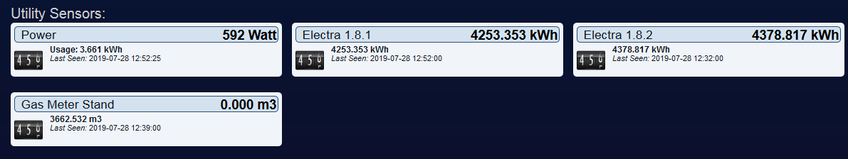

Ragelink
Post by Ragelink »
No Errors anymore, but the data make no sense. Still the Verbruik Laag is " totaal Kwh van de meter"

I also have been playing with the script and modified it a little bit.
The goal was also to get the actual reading from the Gas.
I know that the reading is on one of the boxes under the utility section, but when i set this to favourite the reading is not shown
on the dashboard.
I started to make one new Dummy on the hardware tab, and then created 3 new devices, all
from type General and subtype Counter Incremental.
Below a screenshot how it looks on the utility tab.
Below a screenshot how it looks on the dashboard
I can't get the value of the gas meter.
I also noticed that the values on Electra 1.8.1. an 1.8.2 are not displayed in the same way.
Below the dzvent script i use.
any help would be very welcome !

On the Utility tab press the Edit button of your virtual device. Use Type Gas and counter divider 1
That did almost the trick. The reading is now in m3, but there is nothing to see in the upper right corner.
I merged the script into one but i had to make a few small changes to get the reading i wanted.
I changed return into usage1 and usage2.
Below the script that is running now without errors, only the one mentioned above.
I'am also not running the dzvents version you named in the script.
I run:
Domoticz Version: 4.10717
Build Hash: b38b49e5
Compile Date: 2019-05-09 13:04:08
dzVents Version: 2.4.19
We are getting close to solve this :D :D
--  Parse P1 Smart Meter Electricity value into separate Meter Readings (target devices of type (incremental) counter.
    on =      { timer = { 'every minute' }},
    logging = { level = domoticz.LOG_DEBUG,    -- change to domomticz.LOG_ERROR when all OK
                marker = 'SME 0.2',
    execute = function(dz )
    --  The following need updated for your environment get the 'Idx' or 'Name' of the Device tab.
        local P1 = dz.devices(32) -- Electra, P1 Smart Meter device (= source)
        local P1gas = dz.devices(35) -- Gas, P1 Smart Meter Device (= source)
        local usageLow = dz.devices(36)     -- Meter Usage Low, Virtual device, counter incremental
        local usageHigh = dz.devices(37)    -- Meter Usage High, Virtual device, counter incremental
        local consume = dz.devices(33)       -- Meter Actual Usage, Virtual device, counter incremental
        --local produce = dz.devices(75)     -- Meter Actual Production, Virtual device, counter incremental
        local gas = dz.devices(38)           -- Gas Reading, Virtual device, counter incremental
        local function controledUpdate( device, value, maxTime)
            local timeOut = maxTime or 60
            local cValue = tonumber(device.sValue or device.rawData[1]) -- sValue available in dzVents version > 2.4.21
            if (cValue ~= value) or (device.lastUpdate.minutesAgo > timeOut) then
                device.updateCounter(value)
                dz.log(device.name .. ' (' .. cValue .. ') Updated with ' .. value ,dz.LOG_DEBUG)
                dz.log('No update required for ' .. device.name,dz.LOG_DEBUG)
        controledUpdate(usageLow,P1.usage1)
        controledUpdate(usageHigh,P1.usage2)
        controledUpdate(consume,P1.usage)
        --controledUpdate(produce,P1.usageDelivered)
        controledUpdate(gas,P1gas.counter)
Below the screenshot how it looks now on the dashboard.
Derik
Posts: 1605
Post by Derik »
Dear developer..
Something look wrong..
For a week very big usage etc..
So perhaps something i can change???
I did not set anything else to other value, only update domoticz...
