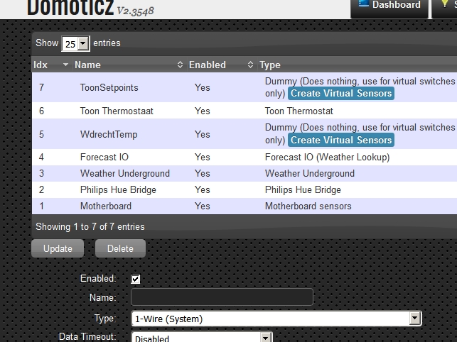

I wanna add Toon scene buttons to set the temperature. So I got few questions.
1. Where exactly to put the scripts?
2. What (virtual) hardware, switches and scenes do I have to setup?
Blah blah blah
jjnj
Re: Toon Energy Readings on Domoticz
Post by jjnj »
I just made a couple of switches for home, away, sleeping and comfort. Those switches are also in use for Alarm etc. But when for example home is switched on a http command will trigger: json.htm?type=command&param=thermostatstate&idx=6&state=1
The state is the warming scene you want to set.
And because I don't know lua yet I just made a blockly: when home is switches, the other switches are switches off of another was on, so only one switch is active and you will know which one
HansieNL
Posts: 964
Post by HansieNL »
What I have done so far...
1 Created dummy hardware
2 Created 4 virtual on/off switches (Thermostaat Comfort, Thuis, Slapen en Weg)
3 Set the on action http command to send when set the switch to on. (Maybe it's better to do that in blocky?)
When I set switch to on, the switch icon change from grey to color and the warming scene state is sent. So this part is working ok. :D
I like the other switches to be switched to off now.
I can't get this working in blocky. :cry:
@ jjnj Is it possible to send me a screenshot of your blocky event?
Blah blah blah

Got it working. I did setup an event as you told me how to do and that works, but now I use the lua script from PD0SBH. The script also set the switch if setpoint is changed on Toon thermostat.
Thanks for helping.

Post by HansieNL »
The picture is a screenshot of my hardware and Toon is added (Idx 6).I've added ToonSetpoints as dummy hardware, because want to have on/off switches for the setpoints.
My question is about the dummy hardware (idx 5 wdrechtemp and idx 7 toonsetpoints). Is just one dummy hardware entry ok and create all virtual sensors from there?
