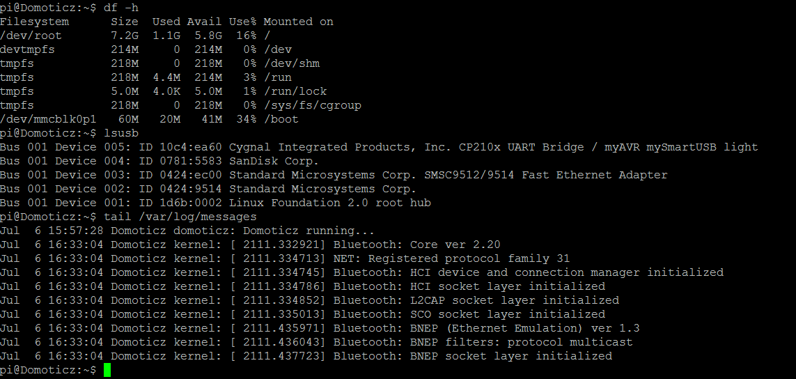

I tried the suggestion of @ guus_b https://www.raspberrypi.org/forums/view ... 29&t=44177, without success. I got stuck very quickly (latest stable Domoticz).
After the command (df -h) the line rootfs is missing.
After ( lsusb) , for me everything seems OK
After ( tail /var/log/messages) , I can not find the USB stick.
What’s wrong?
Thanks in advance

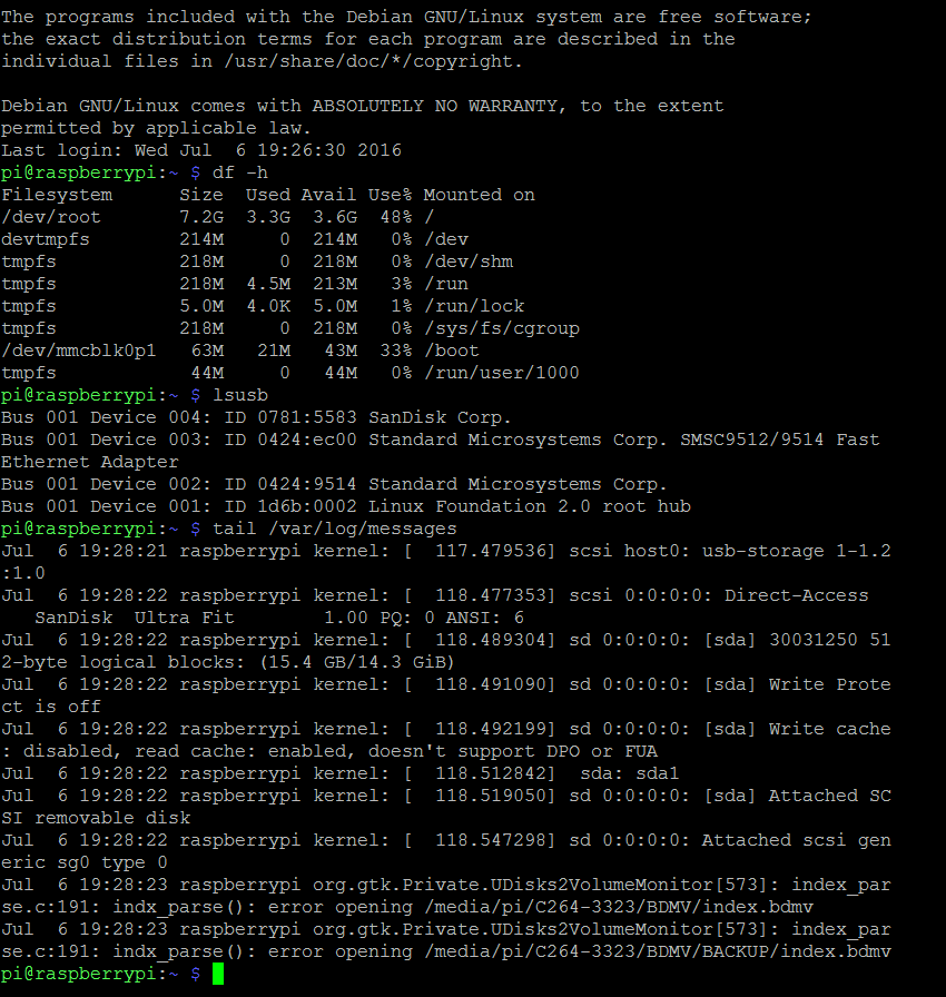

I just started with a fresh Jessie image (without Domoticz). I followed the instructions carefully https://www.raspberrypi.org/forums/view ... 29&t=44177.
Got some errors wich I don't understand. I hope that somebody cab point me in a good direction.

I took a break and then I tried again. I started reformatting the USB stick. It now works as desired.
