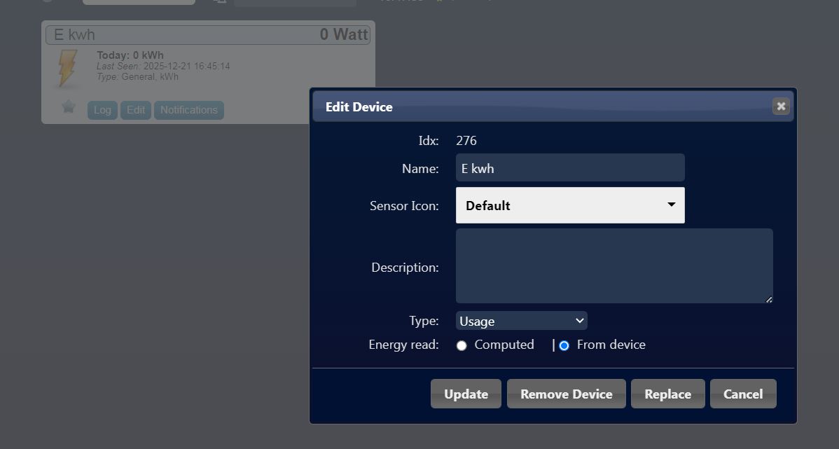

Hello, could someone help? I need to measure and count the amount of thermal energy produced by a kW heat pump. How it do ? Is there such a device or do I need a script?

Re: Domoticz thermal energy kWh, thermal energy meter
What unit of measure do you need? Joules?
Yes of course, I have calculated cop, that's not a problem.
- Posts: 7019
- Domoticz version: 2026.3
Then you can use a normal energy/electricity counter device. But your integration needs to supply the value, else you need to calculate it yourself with eg a dzvents script.

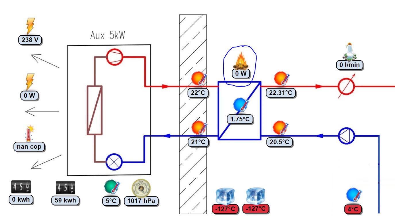

ok
I'm working
I'm working
So correct me if i'm wrong but you want to take Retour to well temperature ( 22.31 C) minus From well temperature (20.5 C) what gives Delta-temperature (dT) of 1.81 C right now.
The flowrate (m) is now zero L/minute but in the calculation you need L/second so divide by 60.
You don't specify the liquid what is used in the well loop so that is a problem to make the right calculation, for now i assume The specific heat capacity (cp) of normal water what is 4180 J/liter.
So the thermal energy calculation (Q) would be now: Q=(m/60)*cp*dT --> Q=(0/60)*4180*1.81 --> Q=0 Watt
I don't know the normal flowrate but lets say it is 10 L/minute this would give Q= (10/60)*4180*1.81 = 1261 Watt

I'm not an automation expert, it's my hobby, I'm just getting started.

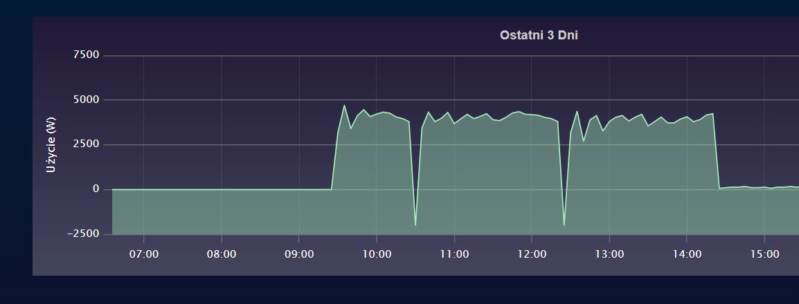

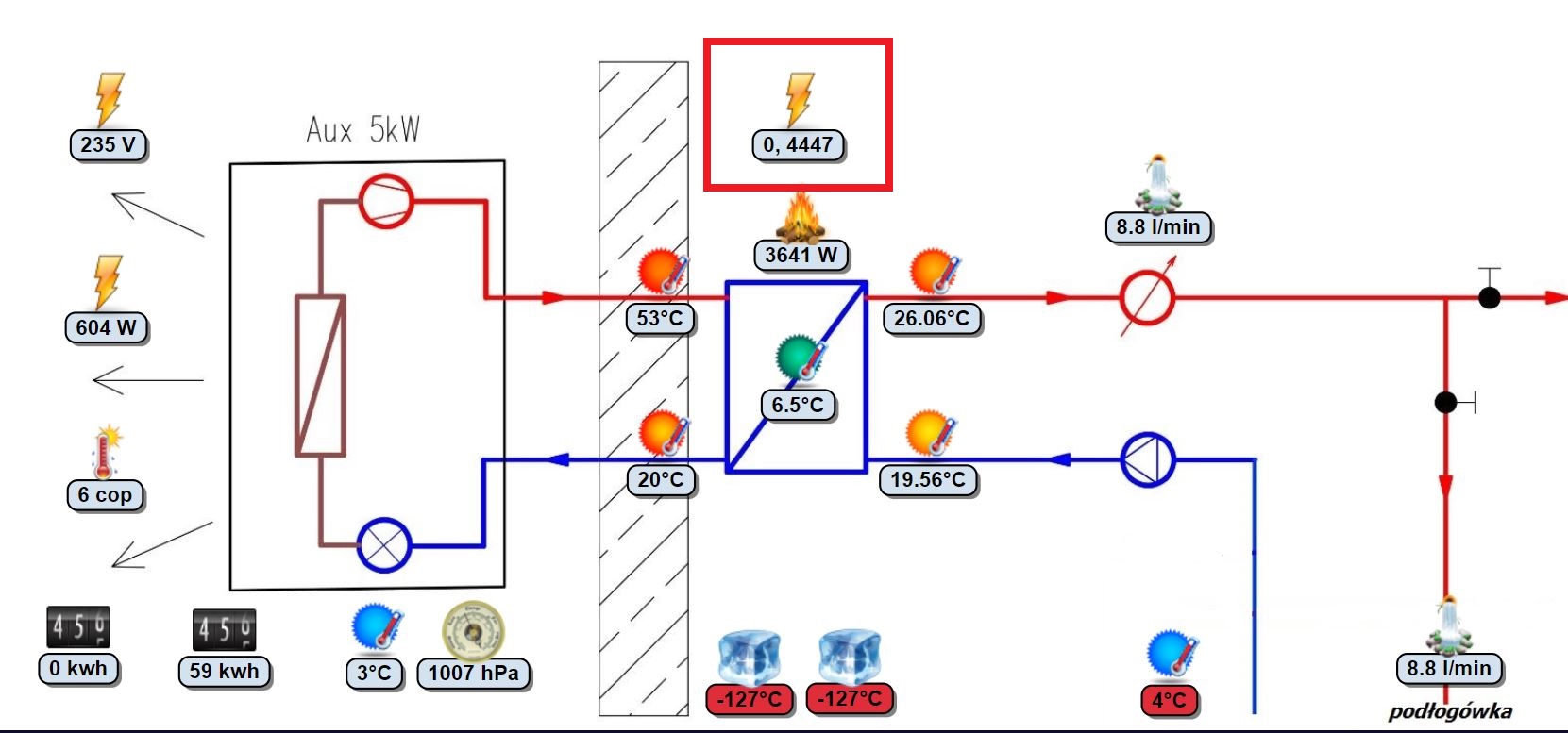

I'm testing to see if I've added the correct device, and then after a day of work, to see if it's counting correctly. But it looks good. Thanks.
I still have a few questions or missing information in my smart home.

I took a screenshot so the delta calculation—you're right—is based on the time interval. Before the correct calculation was made, the previous temperatures were visible.RonkA wrote: Sunday 21 December 2025 17:04 So correct me if i'm wrong but you want to take Retour to well temperature ( 22.31 C) minus From well temperature (20.5 C) what gives Delta-temperature (dT) of 1.81 C right now.

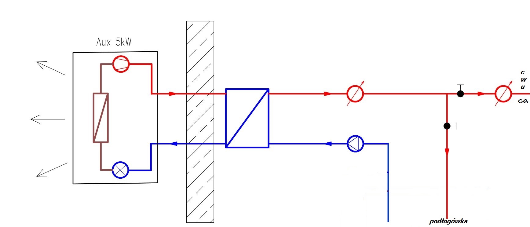

geoterm
- Posts: 29
- Joined: Saturday 20 December 2025 17:41
This is a diagram of an air-source heat pump. To the left of the wall is the outdoor air-source unit, and to the right is the building system with a glycol heat exchanger.
