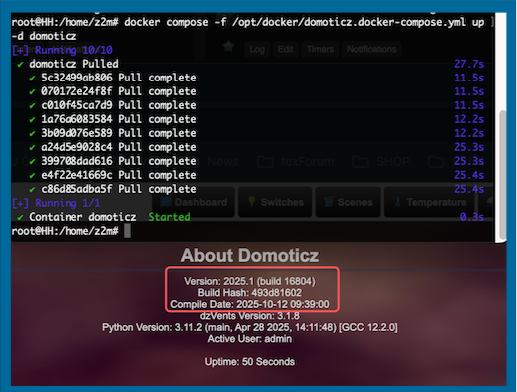

Re: Update via webinterface to 2025.2 troublesome on raspberry pi
Domoticz in Docker version 2025.1
- iScreen Shoter - 20251016161219166.png (225.87 KiB) Viewed 7073 times
