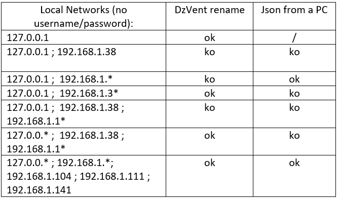

@waaren
I didn't saw your last reply before my message ; I experienced some response time issues on the forum yesterday.
Regarding the "Local Networks (no username/password):", I checked it and there was no changes.
I don't have the same way as you, but specific IPs: 127.0.0.1 ; 192.168.1.108 ; 192.168.1.121 ; 192.168.1.111
hestia
Posts: 361
Joined: Monday 25 December 2017 23:06
Domoticz version: 2022.1
Location: Paris
Re: Issues 2020.2 from build 12020
Post by hestia »
@waaren
following tests done:
http://192.168.1.103:8080/json.htm?type ... cmd=Toggle
from my PC 192.168.1.38
with Version: 2020.2 / Build Hash: b63341bc0 / Compile Date: 2020-04-26 13:47:55
and setting / Local Networks (no username/password) = 127.0.0.1 ; 192.168.1.38 ; 192.168.1.101 ; 192.168.1.31 ; 192.168.1.122
=> status "OK" / title "SwitchLight"
idem with 127.0.0.1 ; 192.168.1.* ; [...] '*' instead of exact list of IPs
=> OK also
with Version: 2020.2 (build 12038) / Build Hash: ac7b37e15 / Compile Date: 2020-05-11 17:20:01
same test with exact list of IPs
1/ setting / Local Networks (no username/password) = 127.0.0.1 ; 192.168.1.38 ; 192.168.1.101 ; 192.168.1.31 ; 192.168.1.122
=> 401 Unauthorized
2/ with 127.0.0.1 ; 192.168.1.* ; [...]
test ok
==>> From my point of view regression confirmed regarding "Local Networks (no username/password)"

addendum:
to avoid the error on internal url:
2020-05-13 21:47:37.241 Error: Error opening url: http://127.0.0.1:8080/json.htm?type=set ... mimage=237
2020-05-13 21:47:37.255 Error: Error opening url: http://127.0.0.1:8080/json.htm?type=com ... il+-+Jeudi
I had to set 127.0.0.* ; 192.168.1.* instead of 127.0.0.1 ; 192.168.1.*

I meant that both issues :
1/ "external json" (from 192.168....)
2/ "internal json" for .setIcon/ .rename (from 127...)
disappear with "*" in the ip address in "Local Networks (no username/password)"
"external json" OK with 192.168.1.* / KO with 192.168.1.38 ; 192.168.1.101 ; 192.168.1.31 ; 192.168.1.122
"internal json" OK with 127.0.0.* / KO with 127.0.0.1
Both seem to be related to "Local Networks (no username/password)" ; there might have been a change around this in a previous beta
And both have been working well with Version: 2020.2 / Build Hash: b63341bc0 / Compile Date: 2020-04-26.
Till more than 1 year for external json.

I made several new tests regarding this issue with an old backup to go back in the past:
With this parameters
127.0.0.1 ; 192.168.1.38; 192.168.1.104 ; 192.168.1.111 ; 192.168.1.141
2 tests
1/ This url from my PC 192.168.1.38
http://192.168.1.35:8080/json.htm?type= ... cmd=Toggle
2/ a rename of device in a dzVents script
Version: 2020.1 (build 11875)
Build Hash: 8c5c9826f-modified
Compile Date: 2020-04-03 08:25:18
dzVents Version: 3.0.2
=> TEST url OK
Upgrade to (release):
Version: 2020.2
=> TEST url OK
=> TEST Rename OK
Upgrade to (beta):
Version: 2020.2 (build 12067)
Build Hash: 0fc3c7b70
Compile Date: 2020-05-17 13:15:45
dzVents Version: 3.0.5
=> TEST url KO 401 Unauthorized
=> TEST Rename KO
2020-05-20 19:51:29.660 Error: Error opening url: http://127.0.0.1:8080/json.htm?type=com ... &name=test
NEW INSTALL (another directory)
Version: 2020.2
Python Version: 3.5.3 (default, Sep 27 2018, 17:25:39) [GCC 6.3.0 20170516]
with Import DB
=> TEST url OK
=> TEST Rename OK
Install last beta (./updatebeta)
=> TEST Rename KO
Remove all blanks between IPs in the Local Networks (no username/password):
=> TEST url OK
=> Rename OK
It seems clear for me that the installation of some betas broked something!
