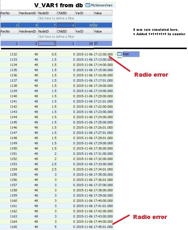

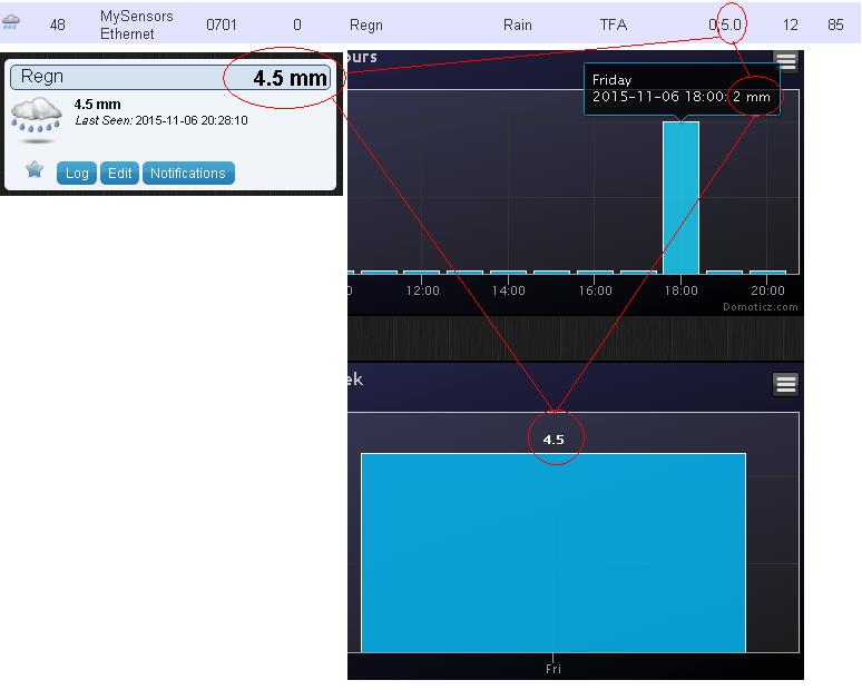

Still, I dont think this is correct or works correct in domoticz (latest beta).
My energymeter works great but not my Raingauge:
Start:
read: 0-0-7 s=1,c=2,t=24,pt=0,l=2,sg=0:52
Received last pulse count from gw: 52
After 10 bucket tips (0.5mm) within the same hour (I send V_RAIN every 0.5 and counter every 1.0)
The bucket has tipped over...
send: 7-7-0-0 s=1,c=1,t=6,pt=7,l=5,sg=0,st=ok:4.5 (V_RAIN)
send: 7-7-0-0 s=1,c=1,t=6,pt=7,l=5,sg=0,st=ok:5.0 (V_RAIN)
send: 7-7-0-0 s=1,c=1,t=24,pt=2,l=2,sg=0,st=ok:57 (V_VAR1)
Result next hour
Start:
Result next hour

best to export your database, and open this in for example 'SQLite Expert Personal'
watch the first counter of the day and the last counter, difference is amount of rain today

Its strange this... i dont know. I will run my node for a couple of days...
It looks like it is the first day it goes wrong. Today it looks better...
My database from yesterday which corresponds to images above: Will return with results...

My fault that I thought V_Rain was supposed to be reset at midning (viewtopic.php?f=42&t=7840)
This is working and V_RAIN works as it should (and as V_KWH).
