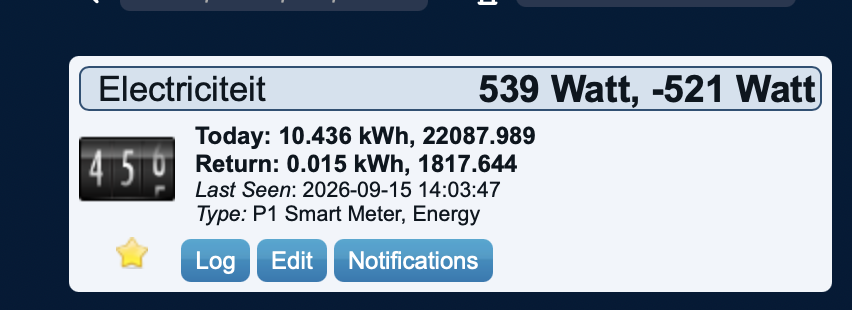

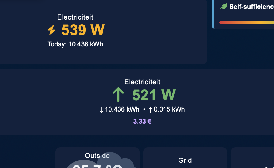

I've place two entry widgets on my dashboard. As you can see on the screenshots, I actually deliver 521 W on phase L1 and consume 539 on phase L2 and L3.
Is it possible to configure one of the widgets with a 'Energy netto'? So in my example 539-521= 'Consuming 18 Watts'?

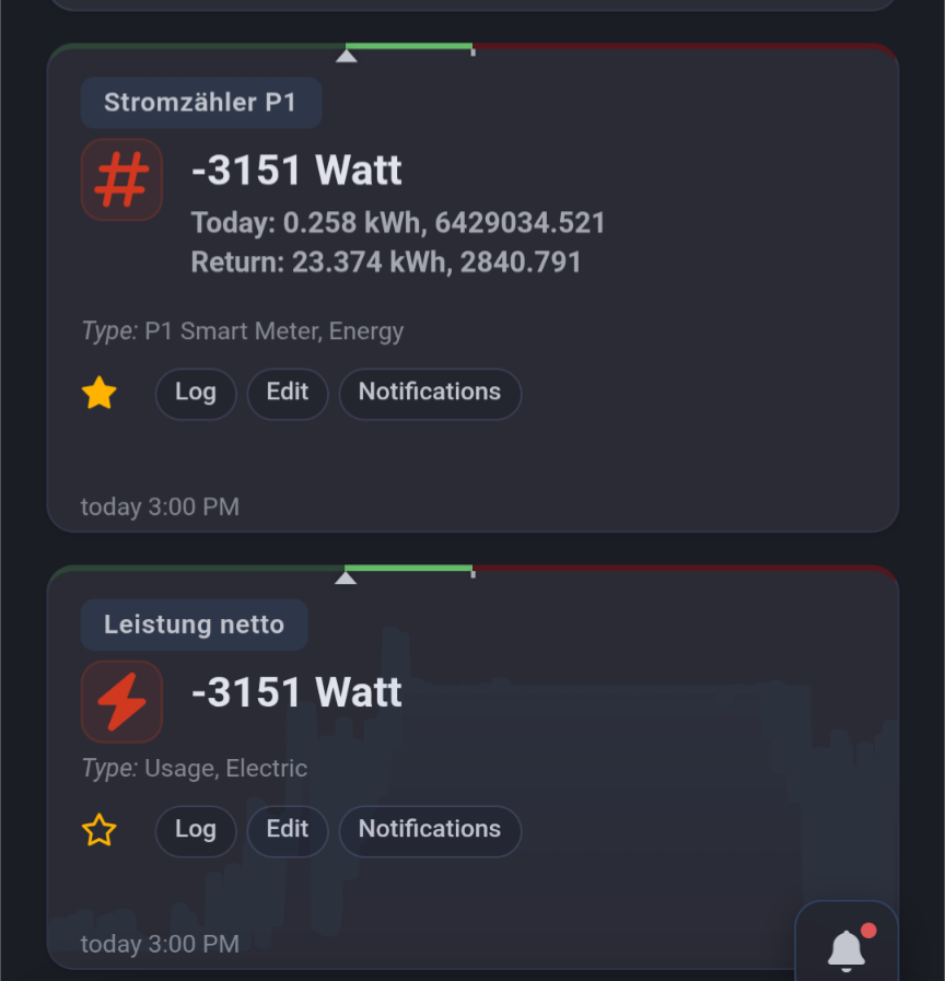

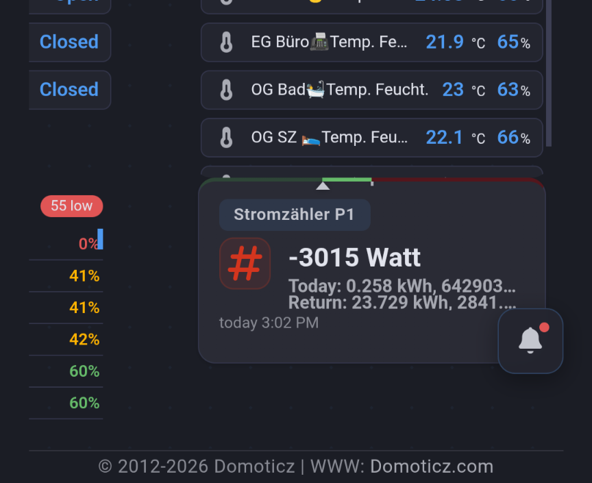

You can add a device widget to the dynamic dashboard and choose the P1 meter. Or if you only want the actual power: I also have a separate utility device that shows the pure netto value (filled by a dzvents script)
- Screenshot_20260916-150023.png (138.69 KiB) Viewed 119 times
- Screenshot_20260916-150259.png (131.25 KiB) Viewed 119 times

@imautohuttraeger The usage, delivery values only are shown when you have a 3 phase connection. Then there could be usage on 1 phase and delivery on another.
@hansbit This has been in the design of Domoticz from the beginning. Workaround would be to create a dummy P1 meter and fill this with the nett values.

Ah - I see. In Germany, the meter shows
Energy counter in kWh for consumption
Energy counter in kWh for production
Actual power in W as a net value (summed up)
Differentiation between consumed and produces power is also measured of course, but not displayed thus the transfered data for Power in Watt to my virtual P1 is only the net value.
