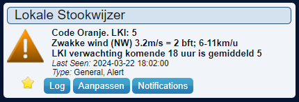

I am willing to share my project in this topic which describes the setup I use for a local alert.
This is a different approach than the RIVM stookalert, which applies to the entire province.
Here it works with local information, with which the advice is calculated in the script.
All 6 items below are needed for it to work:
1. Custom sensor that holds the current local LKI value (Air quality index) based on your coordinates. I have set the axis-label is set to 'LKI'.

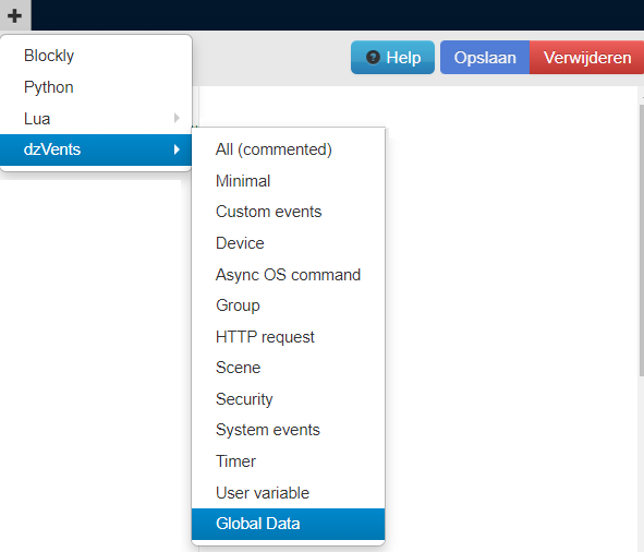

3. Global_data set up where the LKI script stores the calculated avarage LKI for the coming hours in global_data, which will be picked up by the stoke-alert script. I give my entire 'global_data' script. You may or may not want to use the logging function. If not, you have also to modify corresponding lines in the scripts that call this function. Save this script as 'global_data', or take the used variables 'avgnextlkiValues' and 'avgnextlkiHours' in your existing script.
-- 05-01-2023: Script created by Jan peppink, https://ict.peppink.nl
-- This scripts holds all the globally persistent variables and helper functions
-- See the documentation in the wiki
-- NOTE: THERE CAN BE ONLY ONE global_data SCRIPT in your Domoticz install.

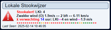

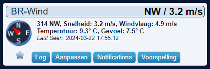

4. Buienradar plugin (or another method with which you can get the current local windspeed). Like the LKI, Buienradar is based on your coordinates.
5. A stoke-alert script that combines the LKI, the stored global_data, the windspeed and winddirection and gives a calculated advice with some additional information. The calculation used is described on https://iplo.nl/thema/lucht/houtstook-s ... d2bfe71123
Or course you have to enter the idx numbers of the used devices.
- Based on information at: https://iplo.nl/thema/lucht/houtstook-stookwijzer-stookalert/#h80dfe1e2-a855-424b-81b4-cdd2bfe71123
- Result: Update 'Lokale Stookwijzer', when 'Luchtkwaliteitsindex' is changed.
- Gives a treee line result with:
--  Alertcolor, Calculated code (in accordance with the definition on https://iplo.nl), current LKI.
--  Winddescription (Winddirection) windspeed in m/s, bft and km/h.
--  LKI expectation (average for number of coming hours that has been received.
- NB.   Expectation counts down when online information is not updatesd.
-       (remains future hours stored in file, until we pass the end of it)
- Depends on LKI device (= local Air Quality Index based on the coordinates).
- Depends on Buienradar 'BR-Wind' device. (Local windspeed based on Buienradar with given coordinates).
- Depends on stored average LKI for coming hours stored in global_data.
- Setting alertLevel by constant:  domoticz.ALERTLEVEL_GREY, ALERTLEVEL_GREEN, ALERTLEVEL_YELLOW, ALERTLEVEL_ORANGE, ALERTLEVEL_RED
- Getting alertLevel by number:    0=gray, 1=green, 2=yellow, 3=orange, 4=red
--Set the device that triggers this script first.

            if windSpeedMs > 32.6 then windText = '\nOrkaan (' .. windDirection .. ') ' .. windSpeedMs .. ' m/s = 12 bft; >117km/u' end
            -- Now start to do something ============
            --domoticz.log('Winds = ' .. windSpeedMs .. ' m/s and lkiValue = ' .. lkiValue)
            if _d.avgnextlkiHours == 0 and _d.avgnextlkiValues == 0 then
                --Code = Geel; No LKI data for current hour received.
                alertText = 'Niet beschikbaar!! Laatste LKI was '  .. lkiValue .. windText .. lkiText
                alertLevel = domoticz.ALERTLEVEL_YELLOW
                -- Update with new alertLevel and alertText.
                domoticz.devices(alertIdx).updateAlertSensor(alertLevel, alertText)
            elseif lkiValue <= 4 and windSpeedMs > 2 then
                --Code = Blauw; You can light the fireplace, but take the neighbors into account.
                --LKI <= 4 and windsspeed > 2m/sec.
                alertText = 'Code blauw LKI: '  .. lkiValue .. windText .. lkiText
                alertLevel = domoticz.ALERTLEVEL_GREEN
            elseif lkiValue >= 5 and lkiValue <=7 and windSpeedMs > 2 then
                --Code = Oranje; It is better not to burn wood now.
                --LKI >= 5 and <= 7 and windspeed > 2m/sec.
                alertText = 'Code Oranje. LKI: '  .. lkiValue .. windText .. lkiText
                alertLevel = domoticz.ALERTLEVEL_ORANGE
            elseif lkiValue >= 8 or windSpeedMs <= 2 then
                --Code = Rood; Do not burn wood.
                --LKI >= 8 and/or the windspeed is low (<= 2m/sec).
                alertText = 'Code Rood. LKI: '  .. lkiValue .. windText .. lkiText
                alertLevel = domoticz.ALERTLEVEL_RED
            alertText = 'LKI: ' .. lkiValue .. " " .. windText .. lkiText

I think it has to do something with the 'global_data' script. Where to place it, how to name it exactly?
janpep
Posts: 268
Joined: Thursday 14 March 2024 10:11
Domoticz version: 2025.1
Re: Dutch local 'Stookwijzer'
Post by janpep »
BazemanKM wrote: Sunday 24 March 2024 12:00 I think it has to do something with the 'global_data' script. Where to place it, how to name it exactly?
Yes indeed. line 50 calls the logging function, so this does not seem to be available.
Steps for how and where to place and name the global_data:
  • Go to the internal editor and start a new script.
  • Replace the content of the template with the content of the global_data script I gave in the first post.
  • Name it 'global_data' and Save it.
That should do it.
Also see the information for the Shared helper functions in the DzVents wiki
And, as said, if you do not want to use the logging function, change it to what you like, comment it out or remove it.
I like it, because in this wayyou can put the logging code everywhere you want for testing. And you can set it on/off or adjust the level by changing only one variable in the beginning of the script.
-- loging level 0 = NO logging, 1 = INFO, 2 = DEBUG, 3 = ERROR or 4 = FORCE
local debug_level = 0

		-- It might happen that windSpeedIdx is not available (when Buienradar is off). SO default wind info to ...
		local windText = 'Lokale wind niet beschikbaar.'
		if domoticz.devices(windSpeedIdx) ~= nil then
			-- Buienradar WindSpeed does exist. Get the info.
			local windSpeedMs = domoticz.devices(windSpeedIdx).speedMs  -- Gets the current value
			local windDirection = domoticz.devices(windSpeedIdx).directionString	-- just for information.
			-- Translate abbreviation into Dutch abbreviation. E(ast) becomes O(ost) S(outh) becomes Z(uid).
			windDirection = string.gsub(windDirection, "E", "O",2)
			windDirection = string.gsub(windDirection, "S", "Z",2)
			-- Cannot remembeer from where I got these naming definitions.

Expansion and improvements of the advice. Major changes in the scripts.
The reason for this was the fact that the wind speed forecast was missing and therefore no advice for the coming period could be calculated.
Finally I added and changed a lot:
  • All data from the same source (Open Meteo, Normal use is free for nun-commercial use without api-key.)
  • Local calculation of the LKI. (Open Meteo gives the components, but not the index as used in the calculation of the advice.)
  • Get also wind speed forcast for the same number of hours from Open Meteo.
  • Therefore a custom wind device shoud be created.
  • Having all the forcast data makes it possible to calculate the advice based on the average of the predicted LKI and wind speed.
  • The number of hours for the forecast is made adjustable between 1 and 72 via setpoint.
  • Therefore a custom setpoint device must also be created.
  • The maximum hour limit can also be set dynamically until 00:00 hour by a variable in the script.

To use the same source for the current and expected values, I have added a new custom wind device. The new script retrieves both current values and expected wind speed from open-meteo.

The result looks like this:
I made the following adjustments to achieve this:
(Please note I sometimes mess around English and Dutch names a bit, but for the sake of convenience I will here stick to the names I use. Call it what you want. Also compared to the earlier scripts, I have renamed a few things.)

- Custom Wind device (Wind+Temp+Chill is used!)

            -- For WIND -----------------------------------------
            if triggeredItem.trigger == 'meteowind' then
                -- Check the response and process the data.
                if (triggeredItem.ok and triggeredItem.isJSON) then
                    _h.logthis( domoticz, debug_level, 'Item and JSON - OK' )
                    -- We have some result. Store in table.
                    local result_table = triggeredItem.json
                    if type(result_table) == "table" then
                        _h.logthis( domoticz, debug_level, 'result_table: type = ' .. type(result_table) )
                        -- Get the current values
                        --"temperature_2m": 10.2,
                        --"apparent_temperature": 6.2,
                        --"wind_speed_10m": 4.71,
                        --"wind_direction_10m": 197,
                        --"wind_gusts_10m": 16.5
                        local temperature = result_table.current.temperature_2m
                        local chill = result_table.current.apparent_temperature
                        local windSpeedMs = _u.round( result_table.current.wind_speed_10m, 1 )
                        local windDirection = result_table.current.wind_direction_10m
                        local windDirectionString = getWindDirectionString( windDirection )
                        local windGust = result_table.current.wind_gusts_10m
                        _h.logthis( domoticz, debug_level, 'Current values - temperature = ' ..  temperature .. '; chill = ' ..  chill .. '; windSpeedMs = ' ..  windSpeedMs ..'; windDirection = ' ..  windDirection .. '; windDirectionString = ' ..  windDirectionString ..'; windGust = ' ..  windGust )
                        intloopCounter = 1
                        local tc = #result_table.hourly.time
                            _h.logthis( domoticz, debug_level, 'Forcasthours = ' .. _d.forcastHours )
                            for i = 1, tc do
                                if result_table.hourly.time[i] > resultTime and intloopCounter <= _d.forcastHours then
                                    _h.logthis( domoticz, debug_level, 'Record = ' .. intloopCounter .. ' - time - value: ' .. result_table.hourly.time[i] .. ' - ' .. result_table.hourly.wind_speed_10m[i])
                                    -- Value for the current hour.
                                    meteowindSpeed = result_table.hourly.wind_speed_10m[i]
                                    totalwindspeedValues = totalwindspeedValues + meteowindSpeed
                                    intloopCounter = intloopCounter + 1
                        -- Calculate and store the average value for future hours in global_data.
                        --NB. This will be used in script d-StookwijzerLokaal.
                        -- Correct intloopCounter for last round
                        intloopCounter = intloopCounter -1
                        _d.avgForcastwindspeed = _u.round( totalwindspeedValues / intloopCounter, 1 )
                        _h.logthis( domoticz, debug_level, 'Found average windspeed = ' .. _d.avgForcastwindspeed .. ' in ' .. intloopCounter .. ' records.')
                        -- Now update our meteowinddevice, which triggers d-StookwijzerLokaal script to produce the advice.
                        _h.logthis( domoticz, debug_level, 'Update ' .. domoticz.devices(meteowind_idx).name  .. '.' )
                        domoticz.devices(meteowind_idx).updateWind( windDirection, windDirectionString, windSpeedMs, windGust, temperature, chill )

3.
I modified global_data
The average LKI and wind speed are stored here. They are called from scripts dt-OpenMeteo and d-Stokwijzerlokaal.
The logging function is also included in this central location, which is used from multiple scripts.
(Change or comment out the logging if it is not desired)

4.
Many modifications to d-StookwijzerLokaal
- Gets LKI and Wind speed from the custom devices to calculate an advice for current hour.
- Gets average LKI and average wind speed from the global_data variables to calculate forcast advice.
- Compose the text advices with color as described before.
- You may also want to be able to overrule the code orange (LKI = 5-7) advice, when there is enough wind. I added two variables for this purpose:
- pepsOverridemode (0 or 1) to toggle on and off.
- acceptableWindspeed, which you can set to the desired treshold that you find acceptable regardless of the LKI (between 5 and 7). I'm still experimenting with this and currently have it set to 5.5, which is between the definition of light and moderate wind.
- To make the advice a bit clearer and to limit the text, I have added the html color of the advice. (In this case, it's a pity that there is no blue alert icon to choose. I want to keep the color codes of the original definition. I thing they wanted to avoid giving it a green light :). )
- Up and down arrows indicate the future development of LKI and wind speed. Color of the arrows (red or green) indicate whether this better or worse). And the color of the text indicates which code applies to the prediction.

Result with dynamic setpoint (Time =- 21:02 hr.)
Note the code blauw-PLUS, which is caused by setting pepsOverridemode =1.
Normally LKI of 5 would give code Oranje. Now with Wind > 5.5 m/s it becomes blauw-Plus.
                if ( triggeredItem.ok and triggeredItem.isJSON ) then
                    if type( result_table ) == "table" then
                        _h.logthis( domoticz, debug_level, 'result_table: type = ' .. type( result_table ) )
                        intloopCounter = 1
                            for i = 1, tc do
                        _h.logthis( domoticz, debug_level, 'Update ' .. domoticz.devices( meteowind_idx ).name  .. '.' )
                        domoticz.devices( meteowind_idx ).updateWind( windDirection, windDirectionString, windSpeedMs, windGust, temperature, chill )

For d-StookwijzerLokaal:
Colorscheme for alerts is changed. See the definition on the site Informatiepunt Leefomgeving.
Code blue no longer exists. They previously avoided the color green, but now apparently want to give even less approval to burning wood in the color code and changed it to yellow.
I comply with these changes in the following manner:
- I think it is more readable to adjust the background color instead of the text color and I have changed that.
- Code blue becomes code yellow. I now show this in the background color of the text, but I keep the alert icon green. You can light the fireplace.
- If pepsOverridemode = 1, then I make the background color darker yellow (between yellow and orange). Then alert icon is still green.
- Code orange and code red remain the same.
Yellow icon was used in case of connection problems. To avoid confusion I decided to use the gray icon for this now.
Colors are set in variables to be able to set it in one place.
I also played with the lineheight in a variable (set to 1.1 now).

Example of the result:

Example where the RIVM alert for the province does not give a warning message, while local conditions with a wind speed of 1.3 m/s give a red alert.

I changed the two major scripts.
d-StookwijzerLokaal for cosmetic reasons and dt-OpenMeteo for the behaviour of the dynamic setpoint.
I'd rather work on the functionality and the code that goes with it, than mess around with the looks. That always takes the most of my time, while I am rarely satisfied with it. :-)
1. d-StookwijzerLokaal
I was not happy with the appearance of colors and background. It did not look nice. Also I did not like the code text. So I have changed the colors and alert text. Also more in line with New Dutch DzVents RIVM Stookalert.
- Also more flexible. You can now set both background and foreground color in variables as you wish.
- I translate code yellow to green (= Geen stookalert). With code yellow they avoid green as a Clearly allowed. :-)
- If pepsOverridemode = 1 (= Lichte waarschuwing stookalert), then darker yellow (not yet orange). Normally LKI of 5 would give code Orange. I created this extra level. Now with Wind > 5.5 m/s it becomes DarkYellow on gray background for readability. Then the alert icon is still green.
- Code orange (= Waaarschuwing stookalert.)
- Code red (= Stookalert!).
The forcast still gives the calculated average for the coming hours while the little arrows up and down with LKI and wind show if the value will increase or decrease (green = better, red = worse). This remained the same.
Here is the script d-StookwijzerLokaal:

		local windDirection = dz.devices( meteowind_idx ).directionString	-- just for information.
    		windDirection = string.gsub( windDirection, "E", "O", 2 )
    		windDirection = string.gsub( windDirection, "S", "Z", 2 )
		-- Cannot remember from where I got these naming definitions.
		if windSpeedMs >= 0 and windSpeedMs <= 0.2 then windText = '<br>Windstil (' .. windDirection .. ') ' .. windSpeedMs .. 'm/s &#8596;0 bft &#8596; < 1 km/u'
		elseif windSpeedMs >= 0.3 and windSpeedMs <= 1.5 then windText = '<br>Zeer zwakke wind (' .. windDirection .. ') ' .. windSpeedMs .. 'm/s &#8596; 1 bft&#8596; 1-5 km/u'
		elseif windSpeedMs >= 1.6 and windSpeedMs <= 3.3 then windText = '<br>Zwakke wind (' .. windDirection .. ') ' .. windSpeedMs .. 'm/s &#8596; 2 bft &#8596; 6-11 km/u'
		elseif windSpeedMs >= 3.4 and windSpeedMs <= 5.4 then windText = '<br>Zeer matige wind (' .. windDirection .. ') ' .. windSpeedMs .. 'm/s &#8596; 3 bft &#8596; 12-19 km/u'
		elseif windSpeedMs >= 5.5 and windSpeedMs <= 7.9 then windText = '<br>Matige wind (' .. windDirection .. ') ' .. windSpeedMs .. 'm/s &#8596; 4 bft &#8596; 20-28 km/u'
		elseif windSpeedMs >= 8.0 and windSpeedMs <= 10.7 then windText = '<br>Vrij krachtige wind (' .. windDirection .. ') ' .. windSpeedMs .. 'm/s &#8596; 5 bft &#8596; 29-38 km/u'
		elseif windSpeedMs >= 10.8 and windSpeedMs <= 13.8 then windText = '<br>Krachtige wind (' .. windDirection .. ') ' .. windSpeedMs .. 'm/s &#8596; 6 bft &#8596; 39-49 km/u'
		elseif windSpeedMs >= 13.9 and windSpeedMs <= 17.1 then windText = '<br>Harde wind (' .. windDirection .. ') ' .. windSpeedMs .. 'm/s &#8596; 7 bft &#8596; 50-61 km/u'
		elseif windSpeedMs >= 17.2 and windSpeedMs <= 20.7 then windText = '<br>Stormachtige wind (' .. windDirection .. ') ' .. windSpeedMs .. 'm/s &#8596; 8 bft &#8596; 62-74 km/u'
		elseif windSpeedMs >= 20.8 and windSpeedMs <= 24.4 then windText = '<br>Storm (' .. windDirection .. ') ' .. windSpeedMs .. 'm/s &#8596; 9 bft &#8596; 75-88 km/u'
		elseif windSpeedMs >= 24.5 and windSpeedMs <= 28.4 then windText = '<br>Zware storm (' .. windDirection .. ') ' .. windSpeedMs .. 'm/s &#8596; 10 bft &#8596; 89-102 km/u'
		elseif windSpeedMs >= 28.5 and windSpeedMs <= 32.6 then windText = '<br>Zeer zware storm (' .. windDirection .. ') ' .. windSpeedMs .. 'm/s &#8596; 11 bft &#8596; 103-117 km/u'
		elseif windSpeedMs > 32.6 then windText = '<br>Orkaan (' .. windDirection .. ') ' .. windSpeedMs .. ' m/s &#8596; 12 bft &#8596; >117 km/u' end

        local lkiSign = '<strong><span style="color: ' .. cMagenta .. '">&#8596;</span></strong>'
		if _d.avgForcastLKI > lkiValue then
		      lkiSign = '<strong><span style="color: ' .. cRed .. '">&#9650;</span></strong>'
		elseif _d.avgForcastLKI < lkiValue then
		      lkiSign = '<strong><span style="color: ' .. cGreen .. '">&#9660;</span></strong>'
        local windSign = '<strong><span style="color: ' .. cMagenta .. '">&#8596;</span></strong>'
		if _d.avgForcastwindspeed > windSpeedMs then
		      windSign =  '<strong><span style="color: ' .. cGreen .. '">&#9650;</span></strong>'
		elseif  _d.avgForcastwindspeed < windSpeedMs then
		      windSign = '<strong><span style="color: ' .. cRed .. '">&#9660;</span></strong>'
        -- Calculate and set the current code.
		if _d.forcastHours == 0 and _d.avgForcastLKI == 0 then
			--Code Gray; No LKI data for current hour received.
			alertLevel = dz.ALERTLEVEL_GRAY
			--Code = Yellow; You can light the fireplace, but take the neighbors into account. I set the Yellow to Green.
			htmlAdviceColor = cGreen
			htmlBackgroundColor = htmlLightBackgroundColor
			alertText = '<span style="background-color: ' .. htmlBackgroundColor  .. '; color: ' ..  htmlAdviceColor .. ';">Geen stookalert.</span> LKI: '  .. lkiValue .. windText
			alertLevel = dz.ALERTLEVEL_GREEN
			--Code Orange; It is better not to burn wood now.
            htmlAdviceColor = cOrange
			alertText = '<span style="background-color: ' ..  htmlBackgroundColor .. '; color: ' ..  htmlAdviceColor .. ';">Waaarschuwing stookalert.</span> LKI: '  .. lkiValue .. windText
			alertLevel = dz.ALERTLEVEL_ORANGE
			--Code Red; Do not burn wood.
            htmlAdviceColor = cRed
			alertText = '<span style="background-color: ' ..  htmlBackgroundColor .. '; color: ' .. htmlAdviceColor  .. ';">Stookalert!</span> LKI: '  .. lkiValue .. windText
			alertLevel = dz.ALERTLEVEL_RED

        if _d.avgForcastLKI <= 4 and _d.avgForcastwindspeed > 2 then
            htmlForcastColor = cGreen
        elseif _d.avgForcastLKI >= 5 and _d.avgForcastLKI <= 7 and _d.avgForcastwindspeed > 2 then
            htmlForcastColor = cOrange
        elseif _d.avgForcastLKI >= 8 or _d.avgForcastwindspeed <= 2 then
            htmlForcastColor = cRed
		-- You may want to override the code orange, when there is a certain wind speed.
		if pepsOverridemode == 1 then
		    -- For current advice.
		    if lkiValue >= 5 and lkiValue <=7 and windSpeedMs >= acceptableWindspeed then
			    -- Added personal level Blauw-PLUS. LKI is higher, but there is wind.
		        htmlAdviceColor = cDarkYellow
		        htmlBackgroundColor = htmlDarkBackgroundColor
			    --alertText = '<span style="background-color: ' ..  htmlAdviceColor .. '">Code geel-PLUS</span> LKI: '  .. lkiValue .. windText
			    alertText = '<span style="background-color: ' ..  htmlBackgroundColor .. '; color: ' ..  htmlAdviceColor .. ';">Lichte waarschuwing stookalert.</span> LKI: '  .. lkiValue .. windText
            -- For the forecast advice color.
            if  _d.avgForcastLKI >= 5 and _d.avgForcastLKI <= 7 and _d.avgForcastwindspeed >= acceptableWindspeed then
			    htmlForcastColor = cDarkYellow
		-- Generate the new forecast.
        alertText = alertText .. '<br><span style="line-height:' .. lineHeight .. '; background-color: ' ..  htmlBackgroundColor .. '; color: ' .. htmlForcastColor .. '"> x&#772; verwachting</span> <span style="color: ' .. cBlue .. '">' .. _d.forcastHours .. '</span> uur: LKI' .. lkiSign .. _d.avgForcastLKI .. ' en wind' .. windSign .. _d.avgForcastwindspeed .. ' m/s'
		-- Now finally update with new alertLevel and alertText we have found.
        dz.log( 'Update ' .. dz.devices( alert_idx ).name  .. '.', dz.LOG_DEBUG )
		dz.devices( alert_idx ).updateAlertSensor( alertLevel, alertText )

When you use two sources, the result can be a bit confusing. The main difference between them is usually the wind speed from the other source.
This can sometimes differ by a few meters per second at the same time.

And I go from one idea to another. I once saw something posted here with a progress bar. I think it would be nice to put the development of the alert code color per hour in a footer bar below the forecast. A graphical trend per hour seems to me a nice addition to the average over the same period.
To give you an idea, here it is in a more primitive way for 25 hour forecast.
Dz on Ubuntu VM on DS718+ behind FRITZ!Box.
EvoHome; MELCloud; P1 meter; Z-Stick GEN5; Z-Wave-js-ui; Sonoff USB-Dongle Plus-E; Zigbee2Mqtt; MQTT; Greenwave powernodes 1+6; Fibaro switch, plugs, smoke; FRITZ!DECT 200. Scripts listed in profile interests.
janpep
Posts: 268
Post by janpep »
Next step with optional colored footer (1 or 0) and configurable amount of hours (1-72).
Here in test example set to 40 hours ahead.
I am thinking of deleting the log file every now and then, because the amount of HTML just makes it bigger and there is not much point in keeping a log of this text anyway.
