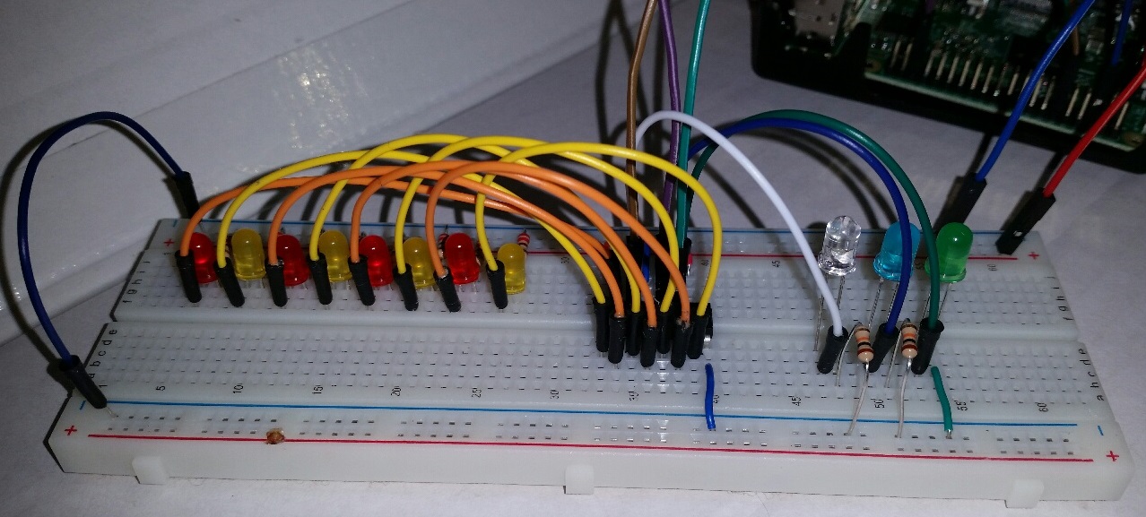

I want to build a 'schematic house' with leds in various rooms. The leds should indicate the status of sensors, activities, alarms, lights and other devices.
Since I am using both KaKu, Z-wave and internet-devices I only have the complete overview of all statuses available from within Domoticz.
I have a basic system working with Arduino with copies of received 433MHZ commands, but I also want Z-wave etc.
I want to make a script (preferably in LUA) that says: 'If device X is On' then 'put PIN x High'. So the Led should lighten up.
Because of the number of devices, I am sure I will need to use a shift-register. So executing commands via os.execute probably won't work.

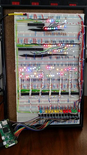

I want to make a "virtual" representation of al devices I have in Domoticz, devided per room.
That is (about) 40 lights, 8 motion sensors, 8 door/window sensors (x 2 open/close = red/green), ventilation, 12 activity-statuses from other sources, physical mailbox, telephone answering-machine, NAS status, power usage (high/low) etc.
In total I assume 80 leds will be needed (or more when I am finished). So that is about 10 shift registers SN74HC595N.
Is it necessary to have such a gadget? Nope! But I want it anyway.
By the way, I have it working with the physical pins from the Raspberry Pi for 14 devices. My next challenge now is the shift register.

OK, so I managed to get a shift-register working.
A short explanation: A shift-register can hold up to 8 bits of information, which would be equal to 8 output pins on a Raspberry Pi or an Arduino.
You can combine several shift-registers to hold 16 bits, 24 bits, 32 bits and so on, of information. This is much more than the number of physical pins on a Raspberry Pi. For the transfer of data to the shift-register, you only need 3 pins, independent of the number of bits you will use.
A shift-register has a data-in-pin where the new bit-status is offered and a clock-pin that - when high - imports that data-bit. This is repeated for all 8, 16, 24 etc bits. When all bits are read, the latch-pin must be set high. At that moment the imported bits are copied to the output-pins.
The clock-timing should be about 1 milli-second. Well, this is the part I have not yet solved. If I set switches in Domoticz on and off without delay this goes far to fast for the shift register to process. And the only delay I know of in Domoticz is the 'AFTER 1' seconds option. This is of course way to slow, but... it is nice to follow the process happen.
If you build the following prototype, you can exactly follow what happens.
And from the back:
The connection of the pins is explained in the script.

You can see what the script is sending by the green, blue and white leds:
When the blue led is off, the shift register is ready to receive information.
When the white led is on there is a bit with the ON state presented. When the white led is OFF, there is a bit with the OFF state presented.
When the green led turns ON, the state as indicated by the white led is read and processed by the shift-register.
This is repeated 8 times.
After that you will see the blue led turn on. At that moment, the input-bits are copied to the output-pins of the shift register.
Well, my next challenge is to find a way to set Domoticz switches with an interval of 1 milli-second.
If you would be the one that knows how to achieve this... please tell me.

Just to show, this is my led-panel.
Each led shows the status of a light, activity, door or window, machine etc. on three floors.
The (bigger) leds at the bottom show communication with Domoticz. The thingy is powered by a Raspberry Pi Zero W with Domoticz. The small black blocks are the shift-registers.
For the foto I used the test-button. It puts all leds on to see if they are functioning.
The "connection" from the Raspberry Pi to the other electronic stuff is done by opto-couplers. From the RaspPi-section to the rest there is no electrical connection.
Some people asked me why I need this. Well I don't.
