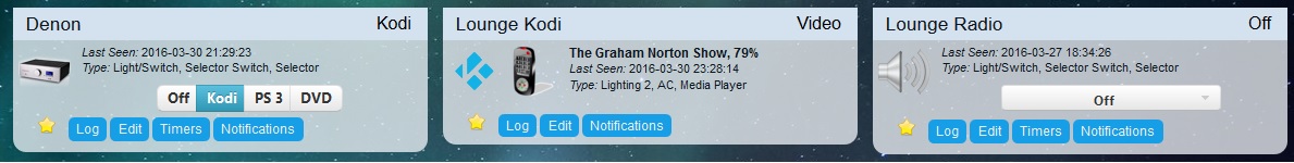

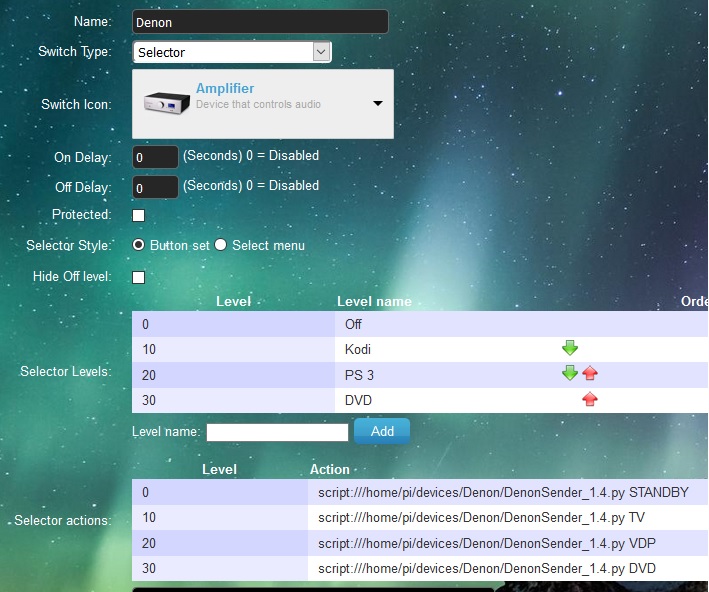

simon_rb, the interface you have mentioned in your post is very functional and much easier to use programatically that the web interface which (IMHO) is complicated and slow.
I use that interface from a Denon AVR 4306 to turn the amp off & on and change input sources from a Python script and map functionality to a number of dummy devices
calling the Python script is done from the selector device:
While this does not do exactly what you want you could trigger a script from a ping device.
The Python to control the device is pretty simple, this script controls power and source (and turns power on prior to setting source):
