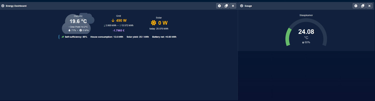

I like the new dashboard, but I am still missing one thing.
You can resize the widget, but the content of the widget does not move with it. I would find it useful if this were possible.
I would use this to make the widget larger on a wall display.
See here the widget is way bigger then the content

Within certain limits, the content of some widgets scales up - or their elements rearrange themselves - when the widget is resized. However, it cannot be enlarged indefinitely. Perhaps, therefore, the maximum scaling factor should be limited.
Stop, look and listen.
