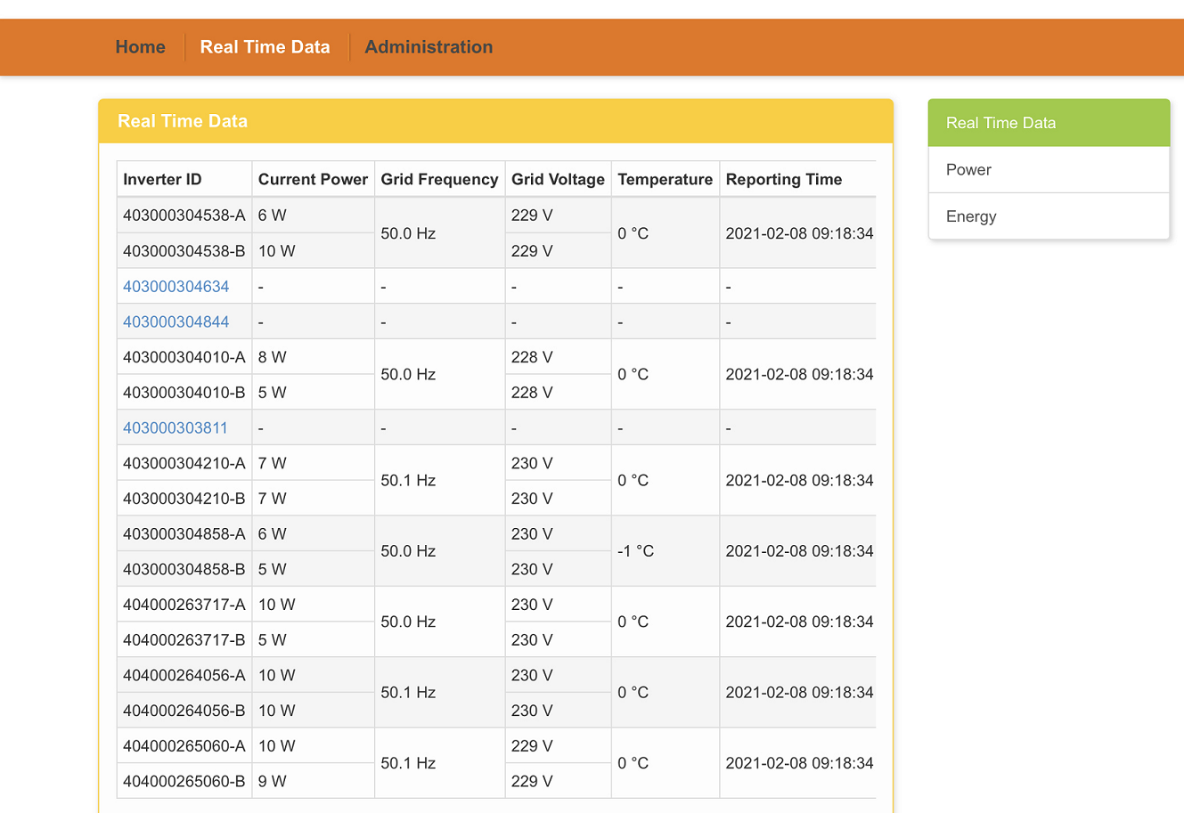

Last week i started with adding ECU-3 it works almost... (although you did this great job in 2019 already, i hope you can help!)
I got some wrong figures at the Solar Panel Sensors.. I think this could be due to there are 10 ten converters in my account and only used 7.
Can one of you help? What do you need from me then?

It was more easy than thought... you can delete the inverters on the administration page from APsystems and only add the ones on the roof..
Now only check how to let it look nice on domoticz.. Until know i didn't find a good theme for that..
Gadget freak - Domoticz beginner - ios and android user

Hi, @lsp242,
So, your problem has been solved? Is the data received by the correct virtual sensors?

@firewizard
Yes problem solved.. I could delete the three extra converters and now the data are correct :D

 5-3-2021 21:57:04node: Output APS Array
msg.payload : array[7]
[ "403000304538", "", "", "", "", "", "" ]
25-3-2021 21:57:04node: Output APS Array
[ "403000304010", "0", "228", "0", "228", "50.1", "19" ]
[ "403000304210", "", "", "", "", "", "" ]
[ "403000304858", "", "", "", "", "", "" ]
