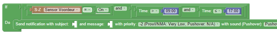

i don't want a delay, what i want is for example:
between 8 and 9 no notification if the door is opend
between 9:01 and 17:00 send notification if the door is opend.
between 17:00 and 18:00 no notification if the door is opend

You can configure that in your blocky event like this:

Thnx i wil try that.
