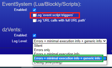

plugge wrote: Wednesday 10 June 2020 14:13 Why doesn't the status tell us which dzVents lua script is executed?
[setup][settings][other]
These status line are from the event system and can be controlled in the red block
The script lines are from dzVents and can be controlled with the green block when you add below lines in the script
    logging =
        level = domoticz.LOG_INFO,

waaren wrote: Wednesday 10 June 2020 18:03
Thanks waaren, I am aware of these settings, but expected that setting "Log 'event script triggers'" would show not just that a lua script was triggered, or a blockly, but the name of the script - or the marker - on the same entry in the log.
Anyway, it's not that important. I'm stil impressed with what Domoticz can do and how it does it. And, coming from Lisp (a looong time ago), I really enjoy lua.
