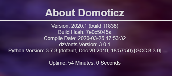

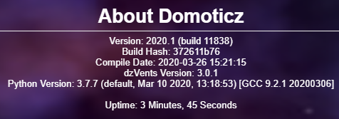

ok, I see you like playing with fire. :D just finished launching the update and it actually did something as now I am in a different build.
now I have the build number in the About box, something you said was added to the beta. So everything looks like it's got me into the beta despite my setting to stay in Stable. :?

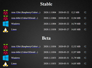

No you are stil on stable :)
I guess @gizmocuz rebuilt a stable for linux to include this.

Silly me, I searched for the latest stable available and thought I was on it already, my mistake. Thanks for your help!
