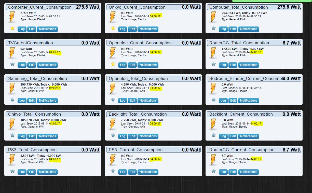

I have a strange problem with my zwave greenwave 6 port switch.
At 4am every day Domoticz stops updating / seeing it.
Hardware: Raspberry Pi 1, Razberry board
Domoticz: Beta 3.5478
I have tried with restarting the raspberry pi but it didn't do any affect, still stopped at a 4 am.
Solution has been to heal network or enable polling on the node.
Or restart domoticz / raspberry pi.
I can still switch on the portsand one port is always on "RouterCC"
TIA
Daniel

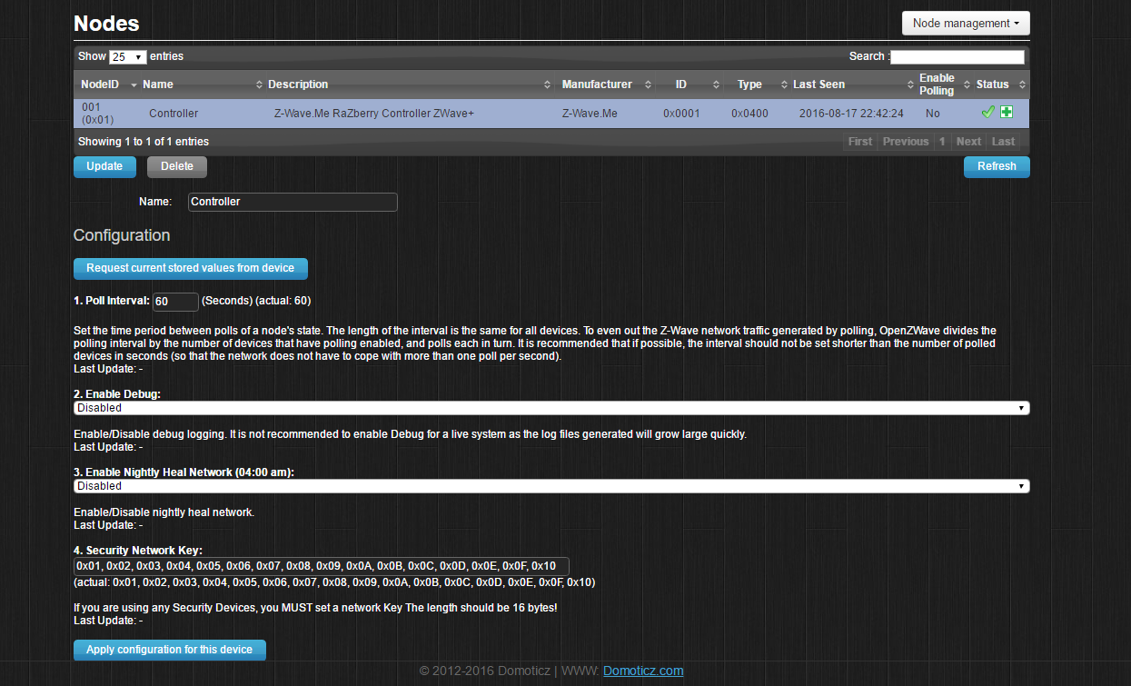

Found this
2016-08-16 04:00:01.908 OpenZWave: Node Removed. HomeID: 3260666225, NodeID: 1 (0x01)
2016-08-16 04:00:07.548 Ending automatic database backup procedure...
2016-08-16 04:00:07.669 OpenZWave: New Node added. HomeID: 3260666225, NodeID: 1 (0x01)
2016-08-16 04:00:10.686 OpenZWave: Node Removed. HomeID: 3260666225, NodeID: 2 (0x02)
2016-08-16 04:00:10.757 OpenZWave: New Node added. HomeID: 3260666225, NodeID: 2 (0x02)
2016-08-16 04:00:11.580 OpenZWave: Node Removed. HomeID: 3260666225, NodeID: 6 (0x06)
2016-08-16 04:00:11.619 OpenZWave: New Node added. HomeID: 3260666225, NodeID: 6 (0x06)
2016-08-16 04:00:12.629 OpenZWave: Node Removed. HomeID: 3260666225, NodeID: 8 (0x08)
2016-08-16 04:00:12.641 OpenZWave: New Node added. HomeID: 3260666225, NodeID: 8 (0x08)
2016-08-16 04:00:13.655 OpenZWave: Unhandled class: 0x87 (INDICATOR), NodeID: 2 (0x02), Index: 0, Instance: 1
2016-08-16 04:00:13.705 OpenZWave: Unhandled class: 0x87 (INDICATOR), NodeID: 6 (0x06), Index: 0, Instance: 1
Skickat från min Nexus 5 via Tapatalk

Varazir wrote: I have a strange problem with my zwave greenwave 6 port switch.
l
Could the automatics healing of the network aroun 4 am coursing your problem?
Pi 2 - Pi 1 - Razzbery 2.0 - Fibaro FGD-211 - Fibaro FGD-212 - Fibaro FGRGBWM-441 (RGBW Module) - Fibaro FGBS321 (Universal Switch) - FGWPF-102 - TBK Home TZ67-G - Synology DS1515+ - Esp Easy (with wemos D1 mini)

Location: Beitem, BE
Re: Greenwave 6ports
Post by Egregius »
Disable it and see ;)
