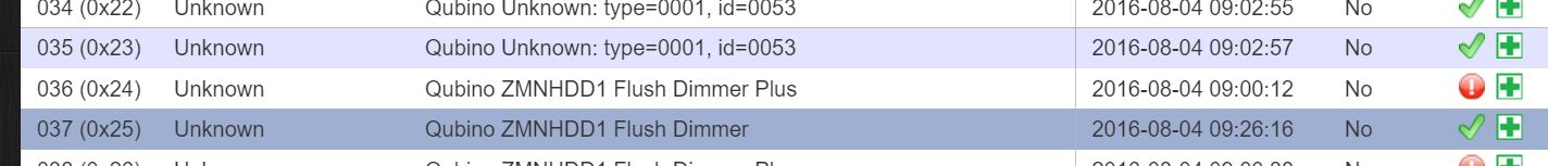

Well now I can't get I2 or I3 to work, I think I can see them in the device list but not possible to activate / deactivate not with the switch or with domoticz.
Its node 37 below that is the Flush Dimmer with I2 & I3, the 0-10V dimmer is shown as "Qubino Unknown: type=0001, id=0053" but works as expected.

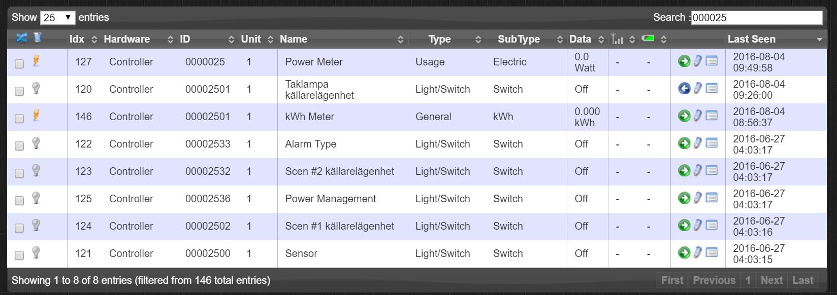

Filtering the devise list on 000025 that should be the node where I have problem I get this list
As you can see I get 6 lines with switches but only "00002501 1 Taklampa källarelägenhet Light/Switch Switch" works and that is of course the switch connected to I1.

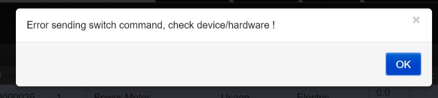

If I click any else of the type "Light/Switch" I get
Any kind person that can help?
