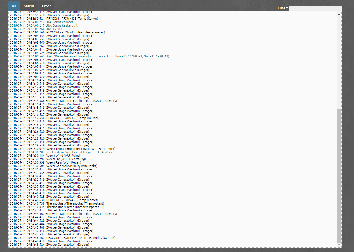

I have a Fibaro FGWPE wall plug to which my dryer is connected. This works great to monitor when the dryer is ready, based on the usage.
But when the dryer is off, I get an update of the usage every few seconds. It seems the dryer is using ~0.3 Watt and then again 0.0 Watt and switches between that. If I pull out the plug of the dryer there are no updates, so this has certainly to do with the fact that the dryer has a small usage when turned off.
In the log I can see the usage is updated very much and I don't want that because of the overload of Zwave traffic (I see a Zwave timeout notification every now and then). Also these updates are not relevant as the dryer is turned off.
Any idea how to fix this?
I already tried to change setting # 42, 43 and 45, but that makes no changes.
Domoticz v3.5075 with Zwave v1.4-167-g733975b.
Domoticz log.png (255.65 KiB) Viewed 1374 times

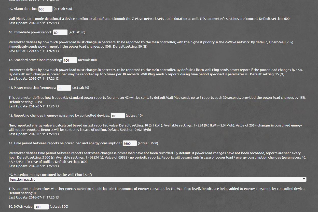

Look at parameter 43. 5 reports ecery 30 seconds...

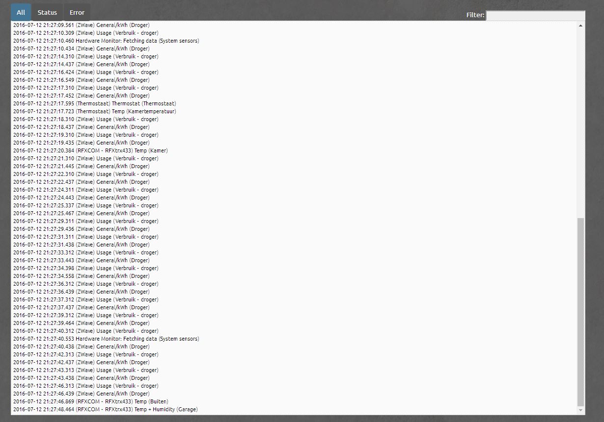

I changed parameter 43 to 180 seconds, but I still get usage updates every few seconds, see the screenshot below.
Any ideas what I have to change?

I have set parameter 40 Immediate power report to 100 and that seems to solve the problem.
