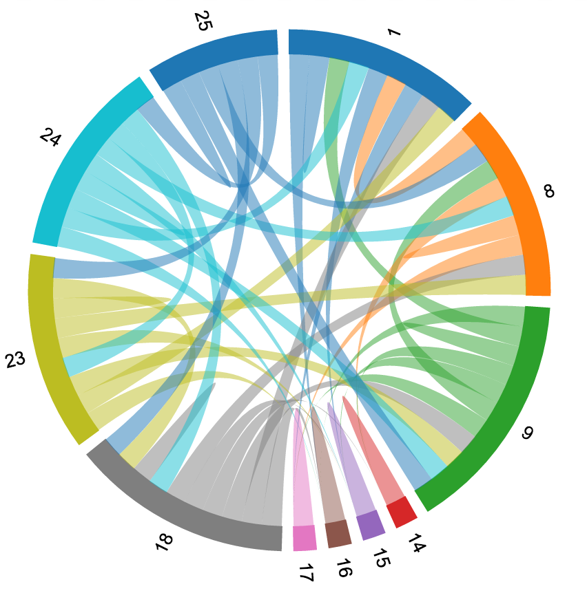

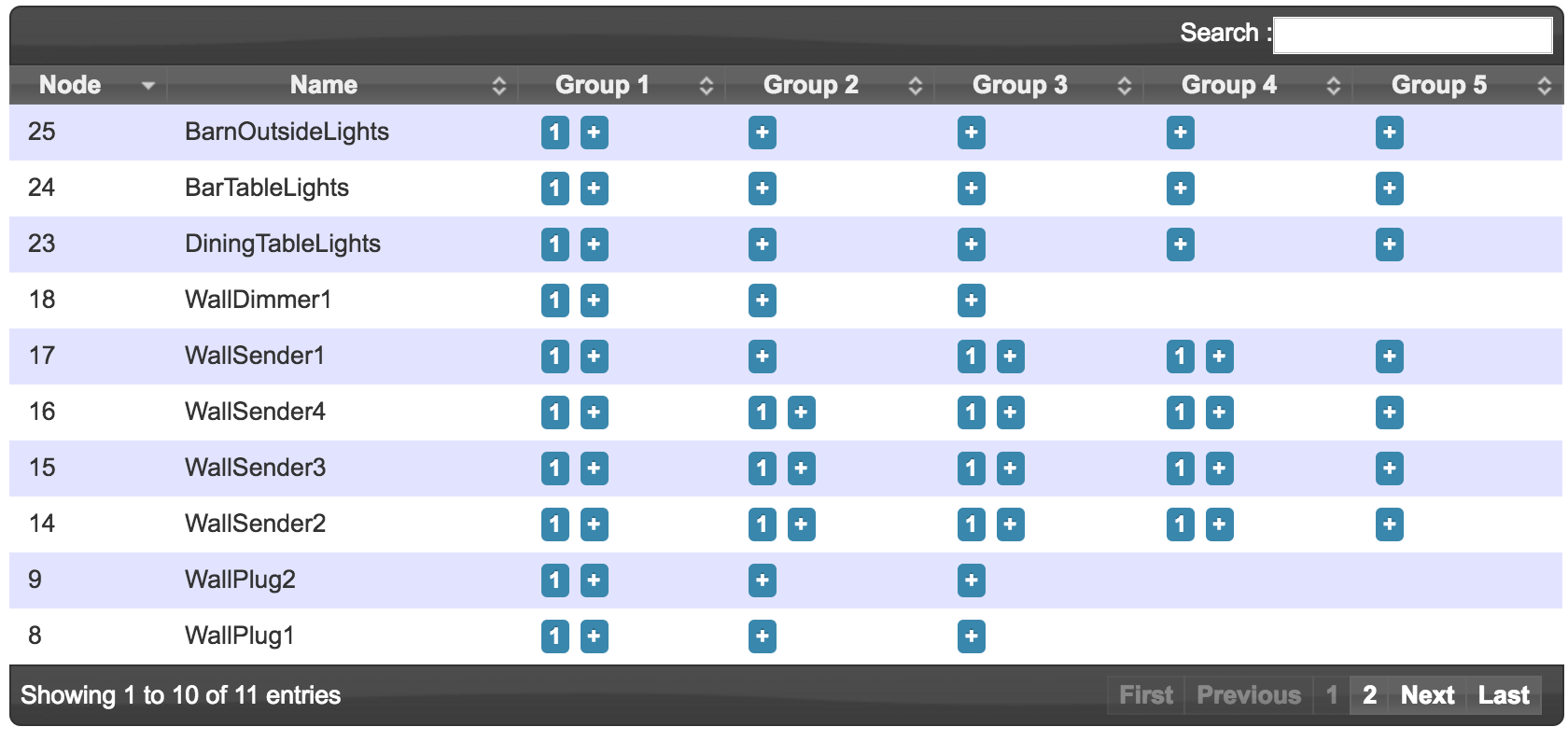

I've put a new/extra dimmer in my house, in the outside barn to be precise. I was able to add the Fibaro dimmer to the Domoticz Openzwave but now I cannot control it (switching on/off). When I checked "Groups and Network" configuration I saw that the new dimmer doesn't have a direct link to the zwave controller. Maybe the distance is to far between the dimmer and the controller. But in between there are a number of other zwave devices that I would expect to retransmit the signal to the controller. Is my understanding correct? How can I configure this?
Attached is an overview of my Groups and Network configuration. The new dimmer is node id 25 and my controller is node id 1

25 is connected to several devices that have direct connections to the controller. 24, 23, 18, 9 and 8.
However, I can't tell which are powered permanently other than 9 and 8. To be a useable repeater, the intermediate node needs to be on all the time and not sleep. I.e. Not battery powered.

Node ID 8 and 9 are Fibaro wall plugs and they are on power 24/7. Node ID 9 is half way between the controller and the Fibaro dimmer in the barn. So this Node ID 9 should relay the command, correct?
Node ID 23 and 24 are also 24/7 powered Fibaro devices.
Is there something that I need to enable in the configuration or so to make clear there is no direct 1 to 1 communication with the controller?
