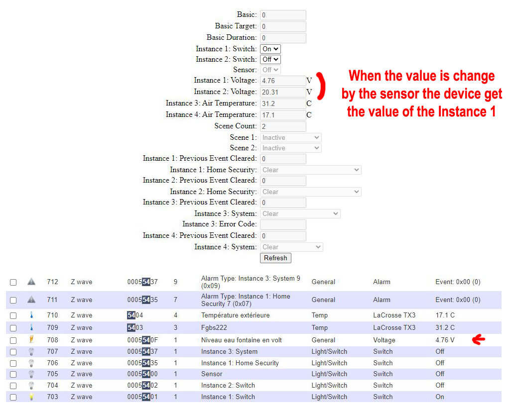

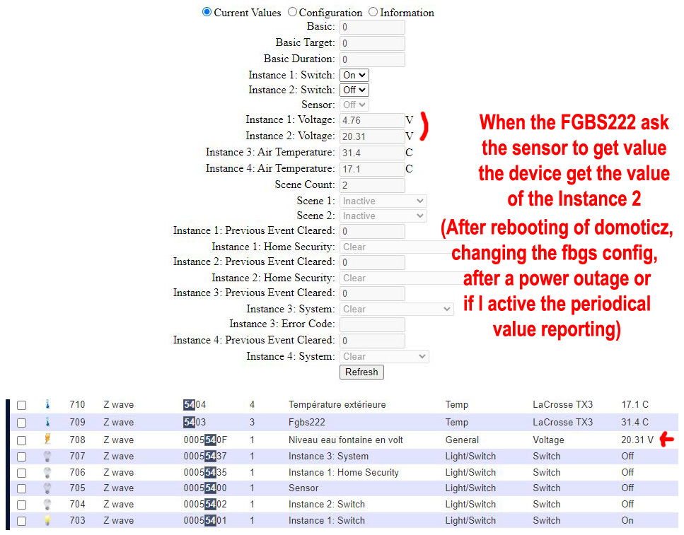

I have add a QDY30A level sensor to my outdoor fontain connect to Fibaro fgbs 222.
(Domoticz 2020.2 Build 12728)
It works fine but you can see my little problem on my attached screenshot.
I have find this possible solution :
https://github.com/domoticz/domoticz/issues/4759
Could you try changing the following code in ZWaveBase.cpp from
SendVoltageSensor(0, lID, BatLevel, pDevice->floatValue, "Voltage");
to
SendVoltageSensor(lID, 0, BatLevel, pDevice->floatValue, "Voltage");
My problem is that I'm not sure that this solution will not create some other problems on my other voltage sensors and I'm hosting my domoticz on a synology DS218plus and I don't find this file under putty (I'm not a boss in linux commandlines)
Can someone help me ?

I have find the solution, installing the last domoticz version on docker :D
