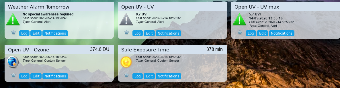

@EdwinK,
I discovered the same issue. See below:
See: https://github.com/Xorfor/Domoticz-Open ... 6e555cecfa
I changed this value to 30 (like 3 before). This means a maximum of 48 requests/day.
Let's wait for another week.
@EdwinK,
As @xorfor has changed the plugin, in order to match the new limit of 50 requests/day, I believe this is on the limit and sometimes it may exceed that limit. The poll frequency is calculated from (24 * 60 / 50), which equals to 28.8. int (28.8) equals to 28 and that is to much.2020-05-01 01:25:56.648 Error: (Open UV) Daily API quota exceeded. Add billing details to get 15000 reqs/day or contact [email protected] to upgrade to Unlimited Plan.
2020-05-01 01:53:57.527 Error: (Open UV) Daily API quota exceeded. Add billing details to get 15000 reqs/day or contact [email protected] to upgrade to Unlimited Plan.

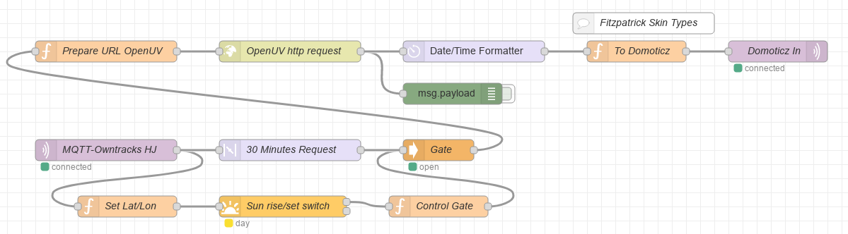

As promised hereby the flow for OpenUV.
For your application (control of your sunscreens) you can simply remove the following nodes:
1. MQTT-Owntracks
2. Set Lat/Lon ( the Lat/Lon co-ordinates can be set in the node "Prepare URL OpenUV", if you modify the contents a little.
3. Sun rise/set switch
4. Control Gate
5. 30 Minutes Request
6. Gate
So the complete lower part can be removed
In order to get a 30 Minutes tick to make a request during daylight, you can use a "day time switch" (node-red-contrib-time-switch),
superseded by an "Inject" node with a 30 Minute tick, like:
Connect the upper output to the input of the "Function" node, called "Prepare URL OpenUV".
The contents of the function node has to be changed to:
In line 30 of the "Function"Node, called "To Domoticz" you might want to change the skin type.
I have inserted skin type 3, but you can change it to another type ( See the comment node).
Please find the complete flow below:

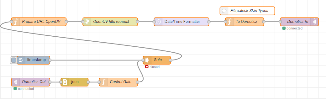

@ Firewizard,
Thanks for sharing your flow. The flow once stimulated me to study Node-RED and MQTT (domoticz/in and domoticz/out). For this I adjust your flow First, is UV Alert a switch? If so, at what value does it switch on?
Otherwise the upper part of the flow works. Like I said I also wanted to play with MQTT. So in Domoticz I made a switch "Night" (IDX = 8) which is "ON" when the sun is down. So the gate must be open when IDX8 is "OFF". I did not change the configuration of "your" Gate I have been struggling with the function node but I need some help. Hopefully you are willing to help.
Thanks in advance.

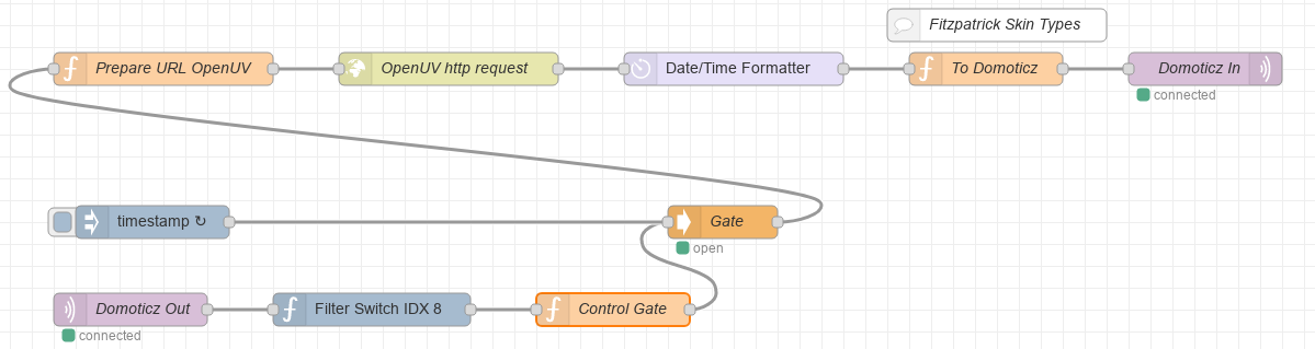

@Jan Jansen,
You wrote:
The contents of my "Function" Node is as follows:
To control the Gate you have to send a message with the topic msg.control, according to:
In your case, you receive from IDX8 an "OFF" during daytime and "ON" during nighttime.
First we have to take care that the function is only activated, if the command is coming from IDX8, so your function should be something like:
Try this code.
The different UV levels are 3, 6, 8 and 11.
This is standard, but you can change it in the "Function" Node, called "To Domotcz".
Best regards

msg.payload = "close";
return msg;In my case, I receive as input a payload of 1, during daytime (and 0, during nighttime)Messages with the topic Control Topic are control messages, which set the state of the gate. Control messages can have values representing open, close, toggle, and default.
if (msg.payload.idx == 8) {
if (msg.payload == "OFF") {
msg.topic = "control";
msg.payload = "open"
else {
return msg;UV-Alert is not a switch, but an "Alert" sensor and it will change the color, according to the alert levelFirst, is UV Alert a switch?
Best regards
Jan Jansen

Hello FireWizard,
Thanks for the detailed explanation. Unfortunately I cannot open the gate. I have tried different settings of the JSON node and alse removed this node. In the control node I changed the line> if (msg.payload == "OFF") to> if (msg.payload === 0).
Hopefully you are willing to take a look at the next flow.
Thanks in advance!
Jan
[{"id":"54563ee4.3724f","type":"tab","label":"Open UV","disabled":false,"info":""},{"id":"41887041.de03a8","type":"function","z":"54563ee4.3724f","name":"Prepare URL OpenUV","func":"var url = \"https://api.openuv.io/api/v1/uv\";\nvar lat = msg.payload.lat || \"51.842739\";\nvar lng = msg.payload.lon || \"5.86347\";\nvar alt = msg.payload.alt || \"10\";\nmsg.url = url + \"?lat=\" + lat + \"&lng=\" + lng + \"&alt=\" + alt;\nmsg.headers = {};\nmsg.headers[\"x-access-token\"] = \"XXXXXXXXXXXXXXXXXXXX\";\n\nreturn msg;","outputs":1,"noerr":0,"x":160,"y":100,"wires":[["6df2e1f8.ba6ec"]]},{"id":"6df2e1f8.ba6ec","type":"http request","z":"54563ee4.3724f","name":"OpenUV http request","method":"GET","ret":"obj","paytoqs":false,"url":"","tls":"","persist":false,"proxy":"","authType":"","x":420,"y":100,"wires":[["8db20686.56f2d"]]},{"id":"4e6d8a4b.050624","type":"function","z":"54563ee4.3724f","name":"Control Gate","func":"if (msg.payload.idx == 8) {\n if (msg.payload == \"OFF\") {\n msg.topic = \"control\";\n msg.payload = \"open\"\n }\n else {\n msg.topic = \"control\";\n msg.payload = \"close\";\n }\n}\nreturn msg;","outputs":1,"noerr":0,"x":470,"y":320,"wires":[["42ad811d.5d234"]]},{"id":"3f946fb4.80d9a8","type":"function","z":"54563ee4.3724f","name":"To Domoticz","func":"// Declarations\n\nvar msg1 ={}; // UV sensor value\nvar msg2 ={}; // UV alert\nvar msg3 ={}; // Max UV\nvar msg4 ={}; // Ozone\nvar msg5 ={}; // Max. Exposure Time\n\n// Function to covert UV index to level\n\nfunction uvi2level(x) {\n\nif (x < 3) {\n return 0;\n} else if (x < 6) {\n return 1;\n} else if (x < 8 ) {\n return 2;\n} else if (x < 11 ) {\n return 3; \n} else {\n return 4;\n}\n}\n\nmsg1.payload = {\"command\":\"udevice\",\"idx\":7,\"nvalue\":0,\"svalue\":msg.payload.result.uv.toFixed(1).toString() + \";0\"};\nmsg2.payload = {\"command\":\"udevice\",\"idx\":9,\"nvalue\":uvi2level(msg.payload.result.uv),\"svalue\":msg.payload.result.uv.toFixed(1).toString() + \" UVI\"};\nmsg3.payload = {\"command\":\"udevice\",\"idx\":6,\"nvalue\":uvi2level(msg.payload.result.uv_max),\"svalue\":msg.payload.result.uv_max.toFixed(1).toString() + \" UVI\" + \"\\n\" + msg.payload.result.uv_max_time};\nmsg4.payload = {\"command\":\"udevice\",\"idx\":1,\"nvalue\":0,\"svalue\":msg.payload.result.ozone.toString()};\nmsg5.payload = {\"command\":\"udevice\",\"idx\":2,\"nvalue\":0,\"svalue\":msg.payload.result.safe_exposure_time.st3.toString()};\nreturn [[msg1,msg2,msg3,msg4,msg5]];\n","outputs":1,"noerr":0,"x":910,"y":100,"wires":[["e7c6f4d4.b2a3"]]},{"id":"e7c6f4d4.b2a3","type":"mqtt out","z":"54563ee4.3724f","name":"Domoticz In","topic":"domoticz/in","qos":"2","retain":"false","broker":"4cbe18fd.401df","x":1110,"y":100,"wires":[]},{"id":"50da51e2.b5eb88","type":"comment","z":"54563ee4.3724f","name":"Fitzpatrick Skin Types","info":"See: https://www.openuv.io/kb/skin-types-safe-exposure-time-calculation\n\n1. Very fair skin, white; red or blond hair; light-colored eyes; freckles likely\n2. Fair skin, white; light eyes; light hair\n3. Fair skin, cream white; any eye or hair color (very common skin type)\n4. Olive skin, typical Mediterranean Caucasian skin; dark brown hair; medium to heavy pigmentation\n5. Brown skin, typical Middle Eastern skin; dark hair; rarely sun sensitive\n6. Black skin; rarely sun sensitive","x":920,"y":60,"wires":[]},{"id":"42ad811d.5d234","type":"gate","z":"54563ee4.3724f","name":"Gate","controlTopic":"control","defaultState":"closed","openCmd":"open","closeCmd":"close","toggleCmd":"toggle","defaultCmd":"default","persist":false,"x":590,"y":240,"wires":[["41887041.de03a8"]]},{"id":"5b9b1522.029444","type":"mqtt in","z":"54563ee4.3724f","name":"Domoticz Out","topic":"domoticz/out","qos":"2","datatype":"auto","broker":"4cbe18fd.401df","x":130,"y":320,"wires":[["ff68ef4a.aa671"]]},{"id":"52fae9dc.b58bc","type":"inject","z":"54563ee4.3724f","name":"","topic":"","payload":"","payloadType":"date","repeat":"1800","crontab":"","once":false,"onceDelay":0.1,"x":150,"y":240,"wires":[["42ad811d.5d234"]]},{"id":"8db20686.56f2d","type":"moment","z":"54563ee4.3724f","name":"","topic":"","input":"payload.result.uv_max_time","inputType":"msg","inTz":"Europe/Amsterdam","adjAmount":0,"adjType":"days","adjDir":"add","format":"DD-MM-YYYY HH:mm:ss","locale":"en_US","output":"payload.result.uv_max_time","outputType":"msg","outTz":"Europe/Amsterdam","x":680,"y":100,"wires":[["3f946fb4.80d9a8"]]},{"id":"ff68ef4a.aa671","type":"json","z":"54563ee4.3724f","name":"Converter","property":"payload","action":"obj","pretty":false,"x":300,"y":320,"wires":[["4e6d8a4b.050624"]]},{"id":"4cbe18fd.401df","type":"mqtt-broker","z":"","name":"MQTT_Server","broker":"localhost","port":"1883","clientid":"","usetls":false,"compatmode":true,"keepalive":"60","cleansession":true,"birthTopic":"","birthQos":"0","birthPayload":"","closeTopic":"","closeQos":"0","closePayload":"","willTopic":"","willQos":"0","willPayload":""}]Thanks in advance!
Jan

@ Jan Jansen.
Please find below some explanation.
1. After the MQTT input node, you use a JSON node, called "Converter" and configured as "Always convert to JavaScript Object".
This is not necessary, because after some versions of the MQTT input node, you can set this easily in the MQTT input node itself.
Select at "Output", "a parsed JSON object", instead of "auto-detect (string or buffer).
So I have taken this out.
2. I have created a simple switch in Domoticz. I assume you did the same.
The switch itself shows On or Off, but not in the JSON object send to domoticz/out if you operate the switch.
In the JSON object you will see nvalue =1, if the switch goes to "On" and nvalue =0, if the switch goes to "Off"
So we have to use this nvalue.
3. By default you will see all messages coming from a number of devices. And this can be a large number.
A node that I often use, in these cases is the "Filter" node. However this is not a default node, after Node Red has been installed.
So you have to install it from the palette.
Therefore:
Open the "Hamburger"menu at the top right and look for "Manage palette".
Go to in the "Install"tab and search for "node-red-contrib-filter".
Install it.
The contents of the "Function" node is then as follows:
You can do it also without the filter node and then the contents is:
In this case it is easier to go without the "Filter" node, but in case you have to filter multiple things, this one is very easy.
The complete flow below:
Best regards
Therefore:
Install it.
if (msg.payload.nvalue == 1) {
} else {
return msg;Code: Select all
} else {
return msg;The complete flow below:
[{"id":"508df59.c00588c","type":"function","z":"5b04ce33.6fd2a8","name":"Prepare URL OpenUV","func":"var url = \"https://api.openuv.io/api/v1/uv\";\nvar lat = msg.payload.lat || \"51.842739\";\nvar lng = msg.payload.lon || \"5.86347\";\nvar alt = msg.payload.alt || \"10\";\nmsg.url = url + \"?lat=\" + lat + \"&lng=\" + lng + \"&alt=\" + alt;\nmsg.headers = {};\nmsg.headers[\"x-access-token\"] = \"XXXXXXXXXXXXXXXXXXXX\";\n\nreturn msg;","outputs":1,"noerr":0,"x":160,"y":100,"wires":[["c7a4b24b.2f12d"]]},{"id":"c7a4b24b.2f12d","type":"http request","z":"5b04ce33.6fd2a8","name":"OpenUV http request","method":"GET","ret":"obj","paytoqs":false,"url":"","tls":"","persist":false,"proxy":"","authType":"","x":420,"y":100,"wires":[["9c2e8602.bdd02"]]},{"id":"b5c9e02a.af832","type":"function","z":"5b04ce33.6fd2a8","name":"Control Gate","func":"if (msg.payload.nvalue == 1) {\n msg.topic = \"control\";\n msg.payload = \"open\"\n }\n else {\n msg.topic = \"control\";\n msg.payload = \"close\";\n}\nreturn msg;","outputs":1,"noerr":0,"x":570,"y":320,"wires":[["4a716dd0.925e14"]]},{"id":"826882ed.321378","type":"function","z":"5b04ce33.6fd2a8","name":"To Domoticz","func":"// Declarations\n\nvar msg1 ={}; // UV sensor value\nvar msg2 ={}; // UV alert\nvar msg3 ={}; // Max UV\nvar msg4 ={}; // Ozone\nvar msg5 ={}; // Max. Exposure Time\n\n// Function to covert UV index to level\n\nfunction uvi2level(x) {\n\nif (x < 3) {\n return 0;\n} else if (x < 6) {\n return 1;\n} else if (x < 8 ) {\n return 2;\n} else if (x < 11 ) {\n return 3; \n} else {\n return 4;\n}\n}\n\nmsg1.payload = {\"command\":\"udevice\",\"idx\":7,\"nvalue\":0,\"svalue\":msg.payload.result.uv.toFixed(1).toString() + \";0\"};\nmsg2.payload = {\"command\":\"udevice\",\"idx\":9,\"nvalue\":uvi2level(msg.payload.result.uv),\"svalue\":msg.payload.result.uv.toFixed(1).toString() + \" UVI\"};\nmsg3.payload = {\"command\":\"udevice\",\"idx\":6,\"nvalue\":uvi2level(msg.payload.result.uv_max),\"svalue\":msg.payload.result.uv_max.toFixed(1).toString() + \" UVI\" + \"\\n\" + msg.payload.result.uv_max_time};\nmsg4.payload = {\"command\":\"udevice\",\"idx\":1,\"nvalue\":0,\"svalue\":msg.payload.result.ozone.toString()};\nmsg5.payload = {\"command\":\"udevice\",\"idx\":2,\"nvalue\":0,\"svalue\":msg.payload.result.safe_exposure_time.st3.toString()};\nreturn [[msg1,msg2,msg3,msg4,msg5]];\n","outputs":1,"noerr":0,"x":910,"y":100,"wires":[["bac06464.1672"]]},{"id":"bac06464.1672","type":"mqtt out","z":"5b04ce33.6fd2a8","name":"Domoticz In","topic":"domoticz/in","qos":"2","retain":"false","broker":"87b7c98f.e7569","x":1110,"y":100,"wires":[]},{"id":"d42df6a6.fdefc","type":"comment","z":"5b04ce33.6fd2a8","name":"Fitzpatrick Skin Types","info":"See: https://www.openuv.io/kb/skin-types-safe-exposure-time-calculation\n\n1. Very fair skin, white; red or blond hair; light-colored eyes; freckles likely\n2. Fair skin, white; light eyes; light hair\n3. Fair skin, cream white; any eye or hair color (very common skin type)\n4. Olive skin, typical Mediterranean Caucasian skin; dark brown hair; medium to heavy pigmentation\n5. Brown skin, typical Middle Eastern skin; dark hair; rarely sun sensitive\n6. Black skin; rarely sun sensitive","x":920,"y":60,"wires":[]},{"id":"4a716dd0.925e14","type":"gate","z":"5b04ce33.6fd2a8","name":"Gate","controlTopic":"control","defaultState":"closed","openCmd":"open","closeCmd":"close","toggleCmd":"toggle","defaultCmd":"default","persist":false,"x":670,"y":240,"wires":[["508df59.c00588c"]]},{"id":"2a6bf001.93be4","type":"mqtt in","z":"5b04ce33.6fd2a8","name":"Domoticz Out","topic":"domoticz/out","qos":"2","datatype":"json","broker":"87b7c98f.e7569","x":130,"y":320,"wires":[["10bbb947.9bc327"]]},{"id":"c5bb1cce.57b1b","type":"inject","z":"5b04ce33.6fd2a8","name":"","topic":"","payload":"","payloadType":"date","repeat":"30","crontab":"","once":false,"onceDelay":0.1,"x":150,"y":240,"wires":[["4a716dd0.925e14"]]},{"id":"9c2e8602.bdd02","type":"moment","z":"5b04ce33.6fd2a8","name":"","topic":"","input":"payload.result.uv_max_time","inputType":"msg","inTz":"Europe/Amsterdam","adjAmount":0,"adjType":"days","adjDir":"add","format":"DD-MM-YYYY HH:mm:ss","locale":"en_US","output":"payload.result.uv_max_time","outputType":"msg","outTz":"Europe/Amsterdam","x":680,"y":100,"wires":[["826882ed.321378"]]},{"id":"10bbb947.9bc327","type":"filter","z":"5b04ce33.6fd2a8","name":"Filter Switch IDX 8","property":"payload.idx","propertyType":"msg","asArray":false,"itemProperty":"","itemPropertyType":"item","rules":[{"t":"eq","v":"8","vt":"num","output":1}],"checkall":"true","outputs":1,"x":350,"y":320,"wires":[["b5c9e02a.af832"]]},{"id":"87b7c98f.e7569","type":"mqtt-broker","z":"","name":"MQTT_Server","broker":"localhost","port":"1883","clientid":"","usetls":false,"compatmode":true,"keepalive":"60","cleansession":true,"birthTopic":"","birthQos":"0","birthPayload":"","closeTopic":"","closeQos":"0","closePayload":"","willTopic":"","willQos":"0","willPayload":""}]
