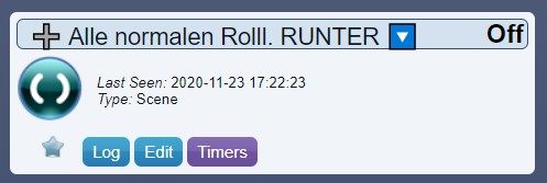

Make a scene, include all the devices you want to control and set the timer(s). That's all. Can be done in a few minutes. I do this with roller shutters and you can do it with smart plugs as well.
So this is not a sync of a "leading" smart plug. But you can interpret this scene as the (virtual) master plug ;-)

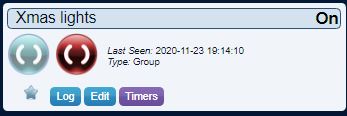

Domoberry
Posts: 132
Joined: Tuesday 30 May 2017 19:00
Domoticz version: 2026.2
Re: Easiest way to control multiple switches from one switch
Post by Domoberry »
Hi Imautohuttraeger,
Thanks for the tip, just what I need and simple!!
My first group...
I did however opt for 'Group' rather than 'Scene' as a Group more closely resembles what I was looking for.
